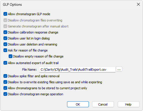

GLP Options
In this dialog, the GLP (Good Laboratory Practice) options for the entireClarity software can be configured. After prompting the System - GLP Options… command, the user is asked to log in. Only users allowed to modify the User Accounts (for more details see also chapter User Accounts) are allowed to enter this dialog. All changes performed in this dialog are logged into the station audit trail.
GLP Options dialog

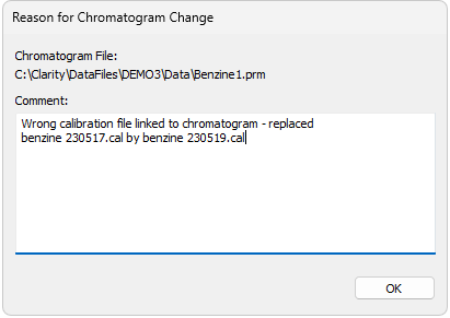

Ask for reason of file change
This checkbox enables to fill in the reason for any file change. When saving a file (e.g., chromatogram, method), the Reason for Chromatogram (Method, …) Change dialog will appear. The user can (but is not obliged to) fill in the reason for the change.
Reason for Chromatogram Change
The reasons for changes are displayed in the Audit Trails, separated by a dash from the file has been saved event.

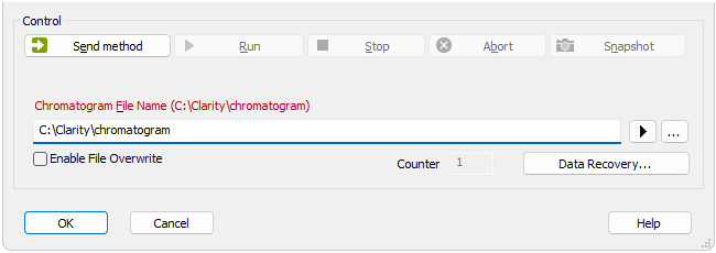

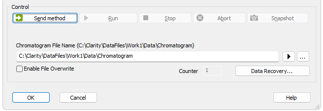

When defining the destination of a newly generated chromatogram, Clarity constantly evaluates the user's input regarding where to store the new chromatogram, and provides feedback to the user. In the Single Analysis window, the feedback provided to the user is displayed above the Chromatogram File Name field. If the given destination is allowed, it is displayed in standard black; if it is prohibited, it is displayed in red.

When the user tries to start analysis with a prohibited destination defined, Clarity will deny to start the analysis and will display the corresponding error message. The user has to adjust the currently defined destination to an allowed one in order to run the measurement.

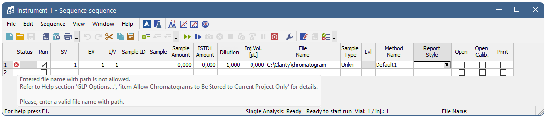

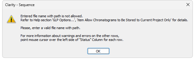

In Sequence, the user is informed about a prohibited destination via a indication in the Status column of the incorrectly set row. If a prohibited path is used, the user is prevented from starting any new analyses and the corresponding error message is displayed. This event is also recorded in Audit Trail.
Sequence - Allow chromatograms to be stored to current project only - Prohibited destination
Sequence - Allow chromatograms to be stored to current project only - Prohibited destination - Error message

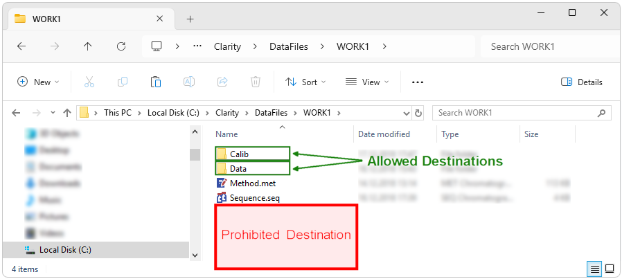

The following image provides an overview of the allowed and prohibited destinations.
Allow chromatograms to be stored to current project only - Destinations

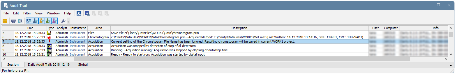

In the case of an unexpected external start of analysis when there is an incorrect location defined, Clarity will apply internal fallback mechanisms and try to store the new chromatogram within a corresponding subfolder (i.e., Data or Calib) of the current project. This exceptional case will be specifically recorded in the Audit Trail as well.
Audit Trail - Allow chromatograms to be stored to current project only - Fallback Mechanism
