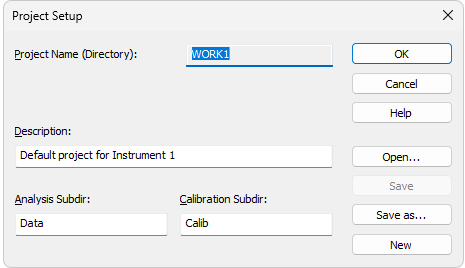

To open the Project Setup dialog, use the menu Instrument - Project… command (icon
) or click the project name in the bottom-right corner of the
Project Setup
Contains both the project name and the project directory. Only methods and sequences will be stored in the project directory (chromatograms and calibration files are stored in the corresponding subdirectories).
Description of the project (this field serves for information only).
Subdirectory for storing data (chromatograms).
Stores calibration standards and calibration files.
More information on the project directory structure can be found here
Selects a new project from a list of existing ones.
Although the same project can be opened in two Clarity Instruments within one station, the same file cannot. However, with multiple Clarity (Lite) stations running in a PC network, this limitation does not apply and the same file can be displayed on any number of stations.
The list of existing projects corresponds to the list of *.PRJ files in the PROJECTS directory.
Saves the displayed project parameters.
Copies the current project and saves it under another name. The project description and the name of data subdirectories are copied automatically. Copies of all files are created only after confirmation.
Creates a new project. Invoking the command displays a list of existing projects where the name of the new project can be entered. Two data subdirectories are offered with the default names DATA and CALIB.
Entered project name must not contain invalid characters, i. e. \ /:*?"< >|.
