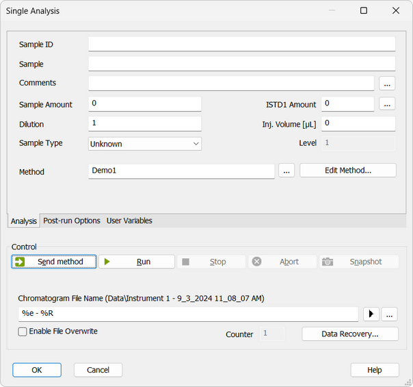

Single Analysis
Prepares and runs a single analysis. Invoking this command opens the Single Analysis dialog, which can also be opened using the
icon in the
Single Analysis - Analysis tab
The Analysis tab can contain different items based on used Extensions (such as GPC or EA), refer to the corresponding manual for their description.
Comprises the description and parameters of single analysis. All entered values are transferred to the chromatogram header during chromatogram creation.
Sample identification field used for information purposes only. Maximum number of characters in this field is limited to 64. Variables that can be used are described in the Chromatogram File Name field (for more details see also chapter Chromatogram File Name)
Sample description used for information purposes only. Maximum number of characters in this field is limited to 64. Variables that can be used are described in the Chromatogram File Name field (for more details see also chapter Chromatogram File Name)
Serves for adding some information about the chromatogram created from current analysis. Comments can be edited in the Comments dialog accessible through the
button.
The value is used in calculations of individual components percentage. For samples with ISTD, enter the sample amount without the ISTD amount. Enter values using the same units that were used in the calibration file (Units - Compound parameter in Calibration Options window). The default value is 0.
The added amount of the internal standards for the ISTD method - the amount of the ISTD1 can be directly edited in the Single Analysis dialog, the amounts for ISTD2 - ISTD10 can be set using the Edit ISTD Amounts dialog accessible through the
button next to it. Always state this parameter in the same units that are used in the calibration file (Units - Compound parameter in Calibration Options window). The default value is 0.
Specifies the dilution factor of the sample, representing the total volume of the solute and solvent combined. Each calibrated amount in the Amount column of the Result Table is multiplied by this value. The default value is 1.
The injected volume of the sample. The responses of all compounds will be corrected by the ratio of this value and the Default Injected Volume parameter from the calibration file in recalibration or calibration calculations. The default value is 0. The units are set in the Instrument Units dialog (described in the chapter "Right section of System Configuration dialog").
Sets the type of the sample being measured. This option cannot be changed during running analysis. Possible options are:
Unknown - denotes an unknown sample and resulting chromatograms will be stored in the data sub-directory.
Standard - specifies the calibration standard. Samples marked as Standard can have the calibration level filled in the Lvl field. Chromatograms marked as calibration standards in the time of creation will be stored in the calib subdirectory instead of the data subdirectory. If the Lvl is filled, calibration (or recalibration) of the calibration file specified in the method is performed.
Blank - in fact a calibration standard with no amount of added sample. Calibration file needs to be specified in the method on the Calculation tab.
Sets the calibration level for calibration or recalibration. This field is active only when Standard option is selected. Calibration file needs to be specified in the method on the Calculation tab.
Displays method which will be used to acquire chromatogram. Name of existing method can be directly inserted into the row or it can be chosen via the
button. To view or edit method which is displayed, simply press the Edit Method... button which will open corresponding method in the Method Setup dialog. During a running analysis another method may still be opened (will not be sent) in the Method Setup.
Section with commands and parameters for controlling an analysis.
Sends method, that is selected in the Method field to the device(s).
The Send Method button is visible only when the detector is configured on the Instrument.
Runs an analysis. Analysis in progress is indicated by the inscription RUNNING in the Status Line below the
icon. The parameters of the current measurement method in the Method Setup - Acquisition dialog cannot be changed while an analysis is in progress.
Invoking Run command during analysis is possible only when External Start setting in Method Setup - Measurement dialog is set to Start-Restart. Clicking the command terminates running analysis and at the same time starts another one - this operation procedure is often called continuous measurement.

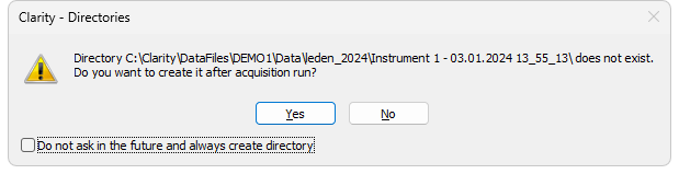

If you enter the Chromatogram File Name including a subfolder which does not exist, for example %B_%Y\%e - %R\%e - %R, then the confirmation dialog about creating the directory will be displayed. When No is selected, the measurement is not started. You can then change or correct the file name and press Run again.
Clarity - Directories dialog when the subdirectory does not exist
Terminates the running analysis and processes the results - a chromatogram is created with the name entered in the Chromatogram File Name field. Followed by post-run events as specified by items from the Single Analysis - Post-run Options tab. The Instrument returns to the STOP or WAITING state. While the program controlling the chromatograph is running, CONTROL is displayed.
Aborts an analysis without storing or processing the data. The instrument will return to either the STOP or WAITING state, the chromatograph controlling program, if any, is aborted.
Processes the existing part of the analysis without its termination. A chromatogram is created using the name specified in Chromatogram File Name field. The processing mode is the same as with the Stop command, the Instrument, however, remains RUNNING. If you are about to replace an already existing file, you will receive a warning, but only upon the first use.
This checkbox enables to perform injection using directly controlled autosampler. Once checked, this option renames Run button to Inject & Run. Incorrect Inj. Volume will prevent you from starting the acquisition. The checkbox will remain checked until the user unchecks it again.
Only an autosampler configured in the System Configuration can be used to perform the injection. If an autosampler is not configured, option to Use Autosampler will be hidden and thus not possible to use.
Specifies vial number from which one injection will be performed. Incorrect vial number triggers an error and must be solved otherwise it is not possible to perform an injection. Autosamplers supporting graphical interface for inserting vial number, display
- clicking this button invokes Select Vial dialog for selecting a vial.
Sample name for created chromatograms. The name can be composed of fixed expressions, as well as variable parameters (e.g. adding time, date and/or sample ID and many other parameters). Fixed part may be combined with the variable part in a single chromatogram name.
Chromatogram File Name is checked for correctness of the name. Upon clicking the Run button, invalid name triggers a message with a description of the problem.
After clicking the
button a list of available parameters and a brief description of their functions is displayed. You may compose the title of the file by selecting the required variables (for more details see also chapter Chromatogram File Name)
It is also possible to include the name of a subfolder in the name to store chromatograms into subfolders of the Data Subdirectory. E.g. the MySubProject\MyFileName in the DEMO1 project will result in the MyFilename.prm stored in the C:\CLARITY\DataFiles\DEMO1\DATA\MySubproject folder. If the subfolder doesn't exist, then it will be created when the chromatogram is stored.
Chromatogram File Name field content can be changed when the analysis is running and will influence the name of its resulting chromatogram, when the change is accepted by pressing the OK button afterwards.
Selects a chromatogram location that is different from the current project. After clicking on this button the Save As dialog will appear. Here you may select a folder for saving the chromatogram.
It is not recommended to save chromatograms outside of their project folder.
This button is most often used for determining the titles of previously existing files in the folder and helps to avoid the use of identical titles. It is also possible to create a new file on the basis of an already existing title.
Enables the overwrite of existing chromatograms without giving notice. It is necessary to close the Single Analysis dialog and open it again for this setting to take effect.
In case the file overwriting is not allowed and the chromatogram with the same name already exists, a chromatogram with the same name and suffix _001.PRM is created instead. The number of such suffix is then incremented in case the necessary file name is already taken.
Shows the current value of the sample counter. If automatic numbering is used for naming chromatograms in the %n format, the current value may be changed here.

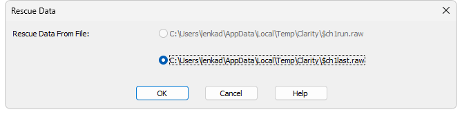

Allows recovering data from an interrupted analysis. If an analysis has been interrupted for any reason (power failure, computer breakdown, invocation of the Abort command, etc.) a portion of the measured chromatogram may still be available.
Invoking the command opens the Rescue Data dialog where you select from the *LAST.RAW and *RUN.RAW files. If no raw file is available, the items are disabled.
Clicking the OK button invokes the Save As dialog.
The *LAST.RAW and *RUN.RAW files are stored in the Temp subdirectory located on local disk in Windows User's account directory (C:\USERS\<user name>\AppData\Local\Temp\Clarity by default).
The *RUN.RAW file will be created only when Clarity station has been unexpectedly terminated while measuring data (e.g. after a power failure). Otherwise the last measured chromatogram is always saved to the *LAST.RAW file.
During the analysis data is saved to the raw file periodically. Frequency of these updates varies based on the detector frequency, it is generally done once per 10-90 seconds (e.g., 20 seconds for detector set to 50 Hz). If a failure occurs before the first data packet is saved to the raw file (soon after analysis start) it only contains the header, trying to recover such file will result in an error.
