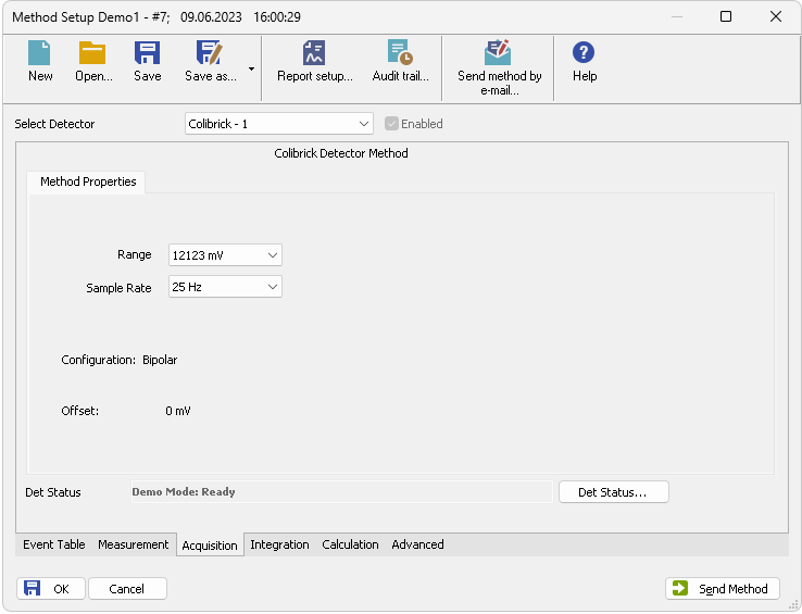

Acquisition
Sets the measuring conditions. When the menu command or
icon is invoked, the Method Setup - Acquisition dialog will be opened. The type of items displayed depends, in part, on the type of A/D converter that has been installed (or the type of chromatograph used while using direct digital acquisition). Be aware that parameters cannot be changed during analysis! The type of the A/D converter along with the name of the detector can be seen in the upper part of the tab.
At the beginning of the acquisition Clarity performs calibration of the A/D converter. Depending on the type of the converter (INT9, U-PAD2, Colibrick, etc.) and Sample Rate the first 20 - 200 ms of the chromatogram will not contain valid data.
Selects between the individual detectors in case several detectors are configured on the same Instrument (multi-detector configuration).
When using a multi-detector configuration, it is necessary to set the parameters individually for each detector.
Enables/disables signal selected in the Select Detector field.
Selects the voltage input range (in mV) and defines the maximum output voltage of the detector that the A/D converter can process.
Specifies the sample rate (ranging from 6,3 to 480 samples per second, depending on the converter used) of a chromatogram. The selected sample rate will affect the ability to measure very narrow peaks. Sufficient number of samples (about 20) is a prerequisite for successful peak detection. This parameter decides on the size of the resulting chromatogram and the speed of its processing.
Available sampling speeds may change with the acquisition equipment used (INT7, INT9, U-PAD, U-PAD2, Colibrick, Net-PAD, digital collection directly from the chromatograph, etc.).
