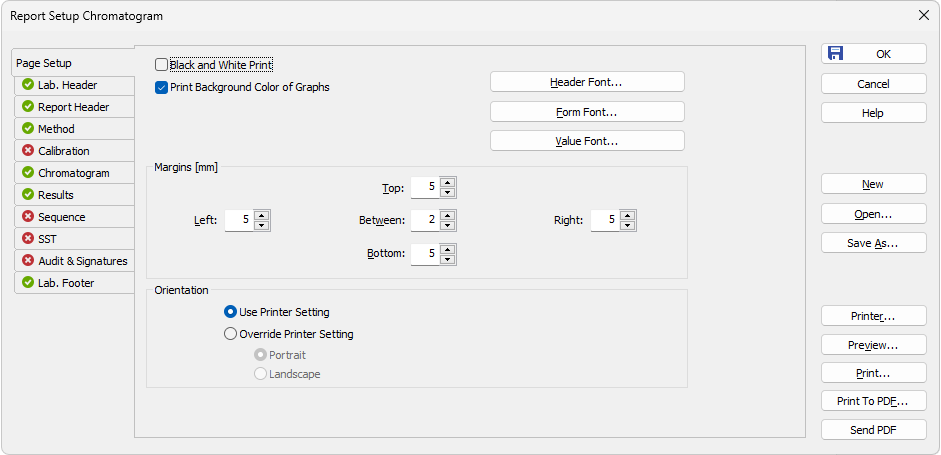

Page Setup
Specifies the setup of the printed page.
Report Setup - Page Setup
Black and White Print
Prints the report in black and white color (even on color printers).
Some black&white printers in MS Windows are identified as color printers. In such case it is necessary to use the Black and White Print checkbox to ensure that the B&W optimization will be applied. These printers would otherwise, for example, not print background colors of the graph.
Print Background Color of Graphs
Prints the background color of the graphs. If not checked, the graph background will be white.
Header Font…
Selects the font for the obligatory header line with the time, file path and page number. Invoking the command will open the standard Font dialog.
Form Font…
Selects the font for item names and table headers. Invoking the command will open the standard Font dialog.
Value Font…
Selects the font for values. Invoking the command will open the standard Font dialog.
In case you want to print PDF Reports in Chinese:
  • You have to install True Type font supporting Chinese signs on your system.
  • You have to set this font to use in Clarity reports.
Margins [mm]
Sets the margins. The allowed range is 0 to 50 mm.
Left, Right, Top, Bottom
Specifies the corresponding margin.
Between
Indicates the space left blank between individual parts of the printed report.
Orientation
Sets the orientation of the printed page. This may be either left on the selected printer setting or overridden by custom page orientation, which is advantageous when using two report styles with different page orientation on the same printer.
Use Printer Setting
Uses the printer page orientation selection for the given report style.
Override Printer Setting
Overrides the printer page orientation selection by one of the available options - Portrait or Landscape. During the selection and preparation of the report style, you might be prompted to select the printer that will be used for the print.
The size and print quality of the printed page are set in the Print Setup dialog of the selected printer (opened by the Printer command in the Report Setup dialog).
