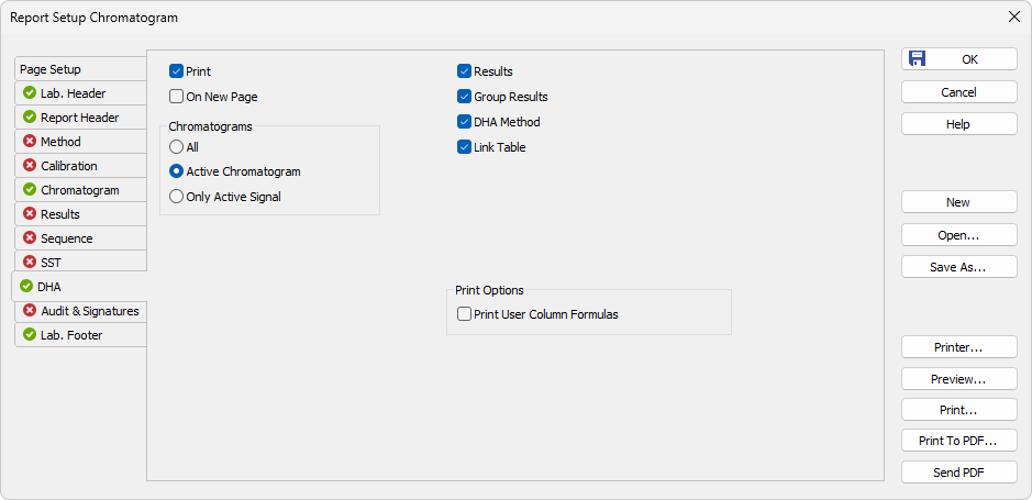

In the Report Setup dialog, tab DHA, you can set the printing options for the data in the DHA Extension.
Report Setup DHA dialog
Enable/disable the printing of the DHA details. If checked, the symbol
will be shown before the tab name, and other fields on the tab will become available.
If checked, the DHA Section is printed on a new page.
Chromatograms
All
Prints data for all chromatograms opened in the Overlay mode.
Active Chromatogram
Prints data for the Active Chromatogram only.
Only Active Signal
Prints data for the Active Signal only.
Results
If checked, prints the DHA - Results.
Group Results
If checked, prints the DHA - Group Results.
DHA Method
If checked, prints the information about the DHA Method.
Link Table
If checked, prints the Link Table.
Defines additional options of the printed report.
Adds calculation formulas used in the User Columns including User Variables at the end of the appropriate table to be printed.
In the GLP mode, formulas are printed automatically, even if this option is unchecked.
