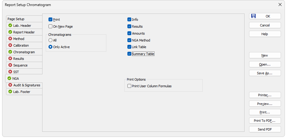

In the Report Setup dialog, tab NGA, you can set the printing options for the data in the NGA Extension.
Report Setup dialog
Enable/disable the printing of the NGA details. If checked, the symbol
will be shown before the tab name, and other fields on the tab will be enabled.
If checked, the NGA Section is printed on a new page.
Chromatograms section
All
Prints the NGA Amounts and NGA Results of all chromatograms opened in the Overlay mode.
Only Active
Prints the NGA Amounts and NGA Results of the Active Chromatogram only.
Info
If checked, prints the NGA Info including the Norm Name and the Norm Table Signature Status.
Results
If checked, prints the NGA Results.
Amounts
If checked, prints the NGA Amounts.
NGA Method
If checked, prints the NGA Method Settings.
Link Table
If checked, prints the Link Table.
Summary Table
If checked, prints the NGA Summary.
Defines additional options of the printed report.
Adds calculation formulas used in the User Columns including User Variables at the end of the appropriate table to be printed.
In the GLP mode, formulas are printed automatically, even if the checkbox is unchecked.
