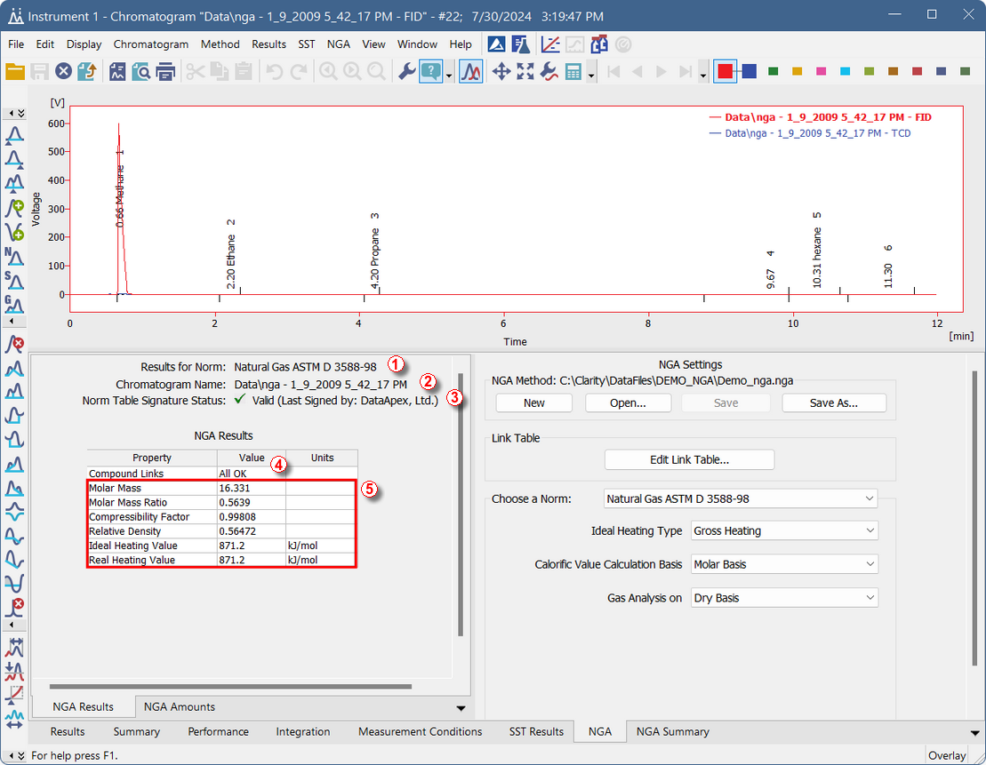

In the NGA Results tab, you can find the table containing results of calculations for the selected norm. Results are automatically recalculated each time you open or change the chromatogram or select different norm (or its parameters).
Chromatogram window - NGA Results
Results for Norm ①
Displays the name of the norm according to which the calculations are performed.
Chromatogram Name ②
Displays the name of the chromatogram for which the results are present (this is helpful especially if you have multiple chromatograms opened in the Overlay Mode).
Norm Table Signature Status ③
Information about the validity of the Norms Table file, where the data required for the calculations are saved. This file is provided by DataApex and is digitally signed. If any changes are done to the file, the signature will be no longer valid.
For any update request in the Norm Table (e.g., adding support for a new norm), contact the DataApex Support at www.dataapex.com.
NGA Results
Compound Links ④
Information about the compounds present in the Result Table(for more details see also chapter NGA Amounts). The field may contain:
  • All OK: There are no errors and warnings in the NGA Results.
  • X Errors: The X is number of the unresolved Compound Names in the NGA Results.
  • X Warnings: The X is number of the compounds not found in Norms Table nor in the Link Table. This warning may occur if you have set the detection of the same compound in more then one signal. For more details see also chapter Calibration - Compounds tab.
For correct results, all warnings and errors should be resolved either by adjusting the calibration or Link Table.
The other rows in the table are respective to the selected norm ⑤
What parameters are calculated in each norm you can find in the chapter "Specification".
