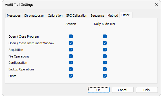

Properties…
The Audit Trail Settings dialog is used to specify which operations will be automatically logged by Clarity station. The operations are classified into six categories: System Messages, Chromatogram, Calibration, Sequence and Method operations and Other. This corresponds to six tabs.
Optional Extensions, like the GPC Extension, may use and display additional tabs. For its description see the manual of the particular Extension.
You can always select whether the events should be logged to Daily Audit Trail or to current audit trail (Session) table and, in case of the events concerning the Chromatogram, Calibration or Sequence windows, to their local audit trails: Chromatogram, Calibration and Sequence.
Local audit trails are displayed from the respective window through the Window - Audit Trail command and their description is in the chapter "Local Audit Trails"
The default setting will log all operations into all relevant files.
You can easily disable the access to the Audit Trail Settings dialog for selected users in the Open Audit Trail Setting field of the User Accounts dialog.
Audit Trail Settings - Messages
Sets whether to log messages concerning export of files and batch operations into the Session audit trail and/or Daily Audit Trail.
Defines whether to log messages concerning problems with acquisition into the Session audit trail and/or Daily Audit Trail.
Defines the logging of messages concerning communication problems with a directly controlled LC chromatograph into the Session audit trail and/or Daily Audit Trail.
Defines the logging of messages concerning communication problems with a directly controlled GC chromatograph into the Session audit trail and/or Daily Audit Trail.
Defines the logging of messages concerning communication problems with a directly controlled autosampler into the Session audit trail and/or Daily Audit Trail.
Defines the logging of messages concerning problems with CE module into the Session audit trail and/or Daily Audit Trail.
Sets whether to log any other system messages into the Session audit trail and/or Daily Audit Trail.
Chromatogram
Selects which chromatogram operations will be logged (for more details see also chapter Properties…)
Calibration
Selects which calibration file operations will be logged (for more details see also chapter Properties…)
Sequence
Selects which sequence operations will be logged (for more details see also chapter Properties…)
Method
Selects which method operations will be logged (for more details see also chapter Properties…)
Defines whether the data concerning the running and shutdown of Clarity station will be logged into the Session audit trail and/or Daily Audit Trail.
Open / Close Instrument Window
Defines whether the data concerning the running and shutdown of the Instrument window will be logged into the Session audit trail and/or Daily Audit Trail.
Defines whether the data concerning the running and shutdown of data acquisition will be logged into the Session audit trail and/or Daily Audit Trail.
Defines whether the operations with files (opening, closing, deleting) will be logged into the Session audit trail and/or Daily Audit Trail.
Defines whether the changes of the station's configuration will be logged into the Session audit trail and/or Daily Audit Trail.
Defines whether the use of the Backup command from the Instrument window will be logged into the Session audit trail and/or Daily Audit Trail.
Defines whether print operations will be logged into the current Global audit trail (Session) or Daily audit trail (Daily Audit Trail).
