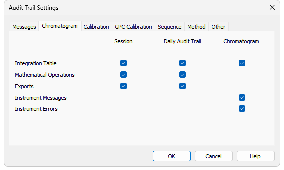

Sets the logging of chromatogram operations into particular audit trails.
Audit Trail Settings - Chromatogram
Defines whether the changes in the integration table will be logged into the current Global audit trail (Session), Daily audit trail (Daily Audit Trail) or Chromatogram audit trail (Chromatogram).
Defines whether a performed mathematical operations will be logged into the current Global audit trail (Session) or Daily audit trail (Daily Audit Trail).
Logging of mathematical operations into the chromatogram audit trail is not performed because they create a new chromatogram instead of modifying the current one.
Defines whether the exporting operations will be logged into the current Global audit trail (Session) or Daily audit trail (Daily Audit Trail).
Defines whether the communication messages sent by and to the controlled instrument will be logged into the current Chromatogram audit trail (Chromatogram).
Defines whether the errors sent from the controlled instruments will be logged into the current Chromatogram audit trail (Chromatogram).

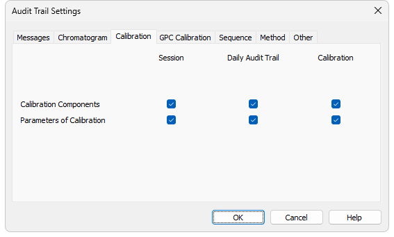

Sets the logging of calibration operations into particular audit trails.
Audit Trail Settings - Calibration
Defines whether the changes in calibrated compounds will be logged into current Global audit trail (Session), Daily audit trail (Daily Audit Trail) or Calibration audit trail (Calibration).
Defines whether the changes to calibration parameters will be logged into the current Global audit trail (Session), Daily audit trail (Daily Audit Trail) or Calibration audit trail (Calibration).

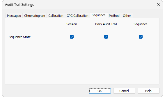

Sets the logging of sequence states into particular audit trails.
Audit Trail Settings - Sequence
Defines whether the changes of the sequence status will be logged into the current Global audit trail (Session), Daily audit trail (Daily Audit Trail) or Sequence audit trail (Sequence).

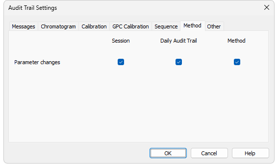

Sets the logging of method changes into particular audit trails.
Defines whether the changes in the method will be logged into the current Global audit trail (Session), Daily audit trail (Daily Audit Trail) or Method audit trail (Method).
