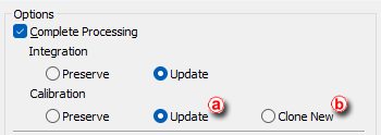

  • In the Batch dialog you have additional option for calibration behavior, the meanings of options are:
  • If you select Update ⓐ in Calibration part of Options section the calibration(s) that are currently linked to measured chromatogram(s) will be recalibrated (new cloning is NOT performed).
  • If you select Clone New ⓑ in Calibration part of Options section new calibration(s) will be created as if the sequence was run again (new clone(s) are created and linked to chromatograms).
