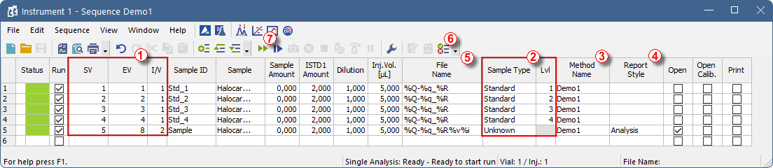

  • Use the Sequence icon in the Instrument window to open the Sequence window.
The Sequence window
  • Look at the Sequence Table. Each row of this table defines one or more analyses, depending on the fields SV (Starting vial), EV (Ending vial) and I/V (Injections per vial) . As shown, the first four rows each represent a single measurement (SV and EV is the same, I/V is 1), while row 5 represents eight analyses (SV is 5, EV is 8; thus measuring 4 samples from 4 successive vials and as I/V parameter is 2, each sample vial will be measured twice).
  • Also note that in the fields Sample Type and Lvl , the first four samples are marked as standards on levels 1-4. Chromatograms measured from those rows will be automatically used for the calibration that is linked to the method.
  • The Method Name column sets the method used for measuring the row.
  • The Report Style column sets the print style used for reporting.
  • In the File Name column …, the name of the resulting chromatogram file is specified. It is recommended to use variable parameters to form the chromatogram filename, for example %Q means that the file name will use the text from the Sample field. The complete set of available variables can be listed after clicking in the field and selecting the icon. It is possible to combine several of these variables with plain text or symbols to create a unique file name for each chromatogram.
  • To verify the sequence setup, click on the Check Sequence icon . The Clarity station will change all symbols at the beginning of the row to green fields (), meaning the rows are ready, or display an error/warning message if a problem is detected. The error/warning message is accompanied with a list of corrections for each case, guiding you on what needs to be fixed before proceeding.

  • Already measured rows will change their Status from green field () to blue icon with small chromatogram (). During the measurement, the icon is orange.
  • A small triangle will appear in the icon if a chromatograph is produced by the particular measurement in the row. Left mouse click on the triangle will open the menu where you can open the measured chromatogram(s). You can click on the name of the chromatogram to open it or select option to open all chromatograms in overlay as seen in Fig "Opening chromatograms in overlay"
  • On the right side of the Sequence Window you can check at each row whether corresponding chromatogram should be opened, printed or loaded into the calibration window. These columns are part of the so-called Post-run Options.
  • In the Sequence, there are many more hidden columns including the rest of the Post-run Options, they can be displayed by right-clicking the sequence table and selecting Setup Columns. In the following dialog move columns that should be displayed to Show Columns list.
