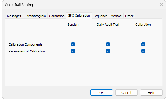

As the GPC Calibration window is not the same as the normal Calibration window, the events that should be saved into the audit trail log might also differ. On the Clarity instrument marked as GPC instrument, a new tab in the Audit Trail Settings dialog appears:
The options to be enabled or disabled on this tab are the same as the options available on the Calibration tab of the Audit Trail Settings dialog, but relate only to the GPC Calibration operations.
