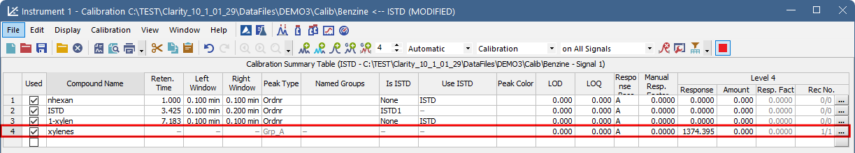

  3. The cursor is locked to the calibration standard graph. Choose the desired group by clicking on it in the graph.
New row will be inserted in the Calibration Summary Table. Here you can change the Group name in the Compound name cell and set other parameters in their respective fields. The group name will be also displayed in the Result Table of the Chromatogram window if the calibration is linked.
