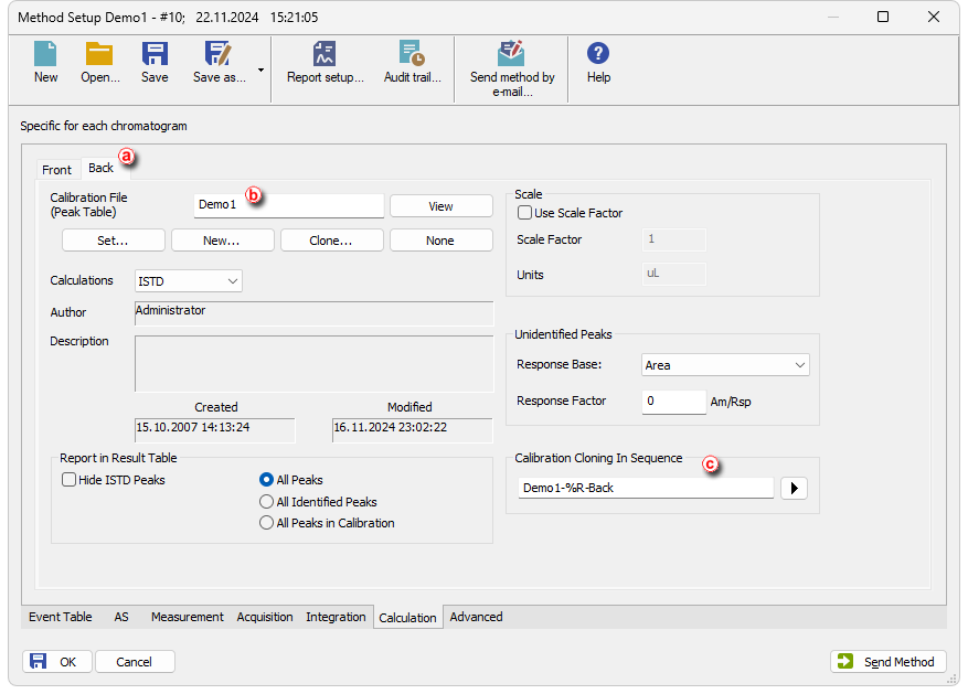

2. Creating a method
- In the Method Setup dialog, create a new method, or adapt an already existing one to the Dual Chromatogram Mode configuration.
- Set the acquisition parameters for all controlled devices.
- Fill in the Run Time on the Measurement tab.
- If you want to calibrate the results, for each detector signal position ⓐ, set different Calibration Files ⓑ. Also, fill in the name of cloned calibration ⓒ for both positions if calibration cloning will be performed.
The User Guide - Create Calibration topic contains detailed instructions on how to create a calibration. - Fill in any other necessary method parameters (e.g., auxiliary signals settings).
