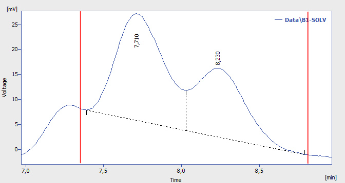

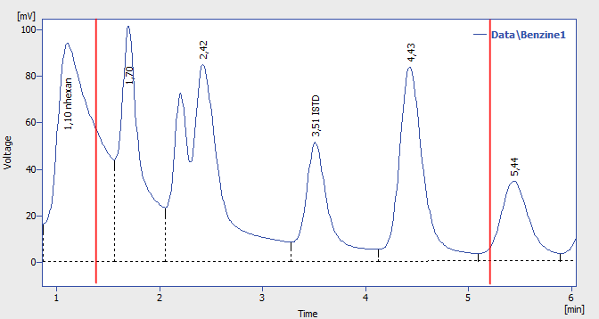

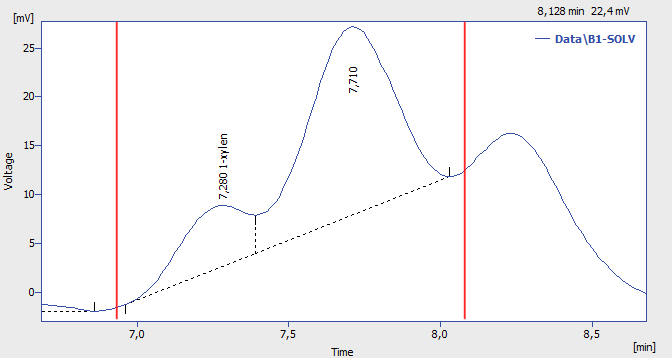

Valley
                                            The Valley command or
 icon forces the baseline into all the valleys situated between the interval lines. In the event this might result in having the baseline intersect with the signal, the station will prevent	the intersection by automatically shifting the peak beginning or end. This operation is opposite to the Together command.
Baseline into valley

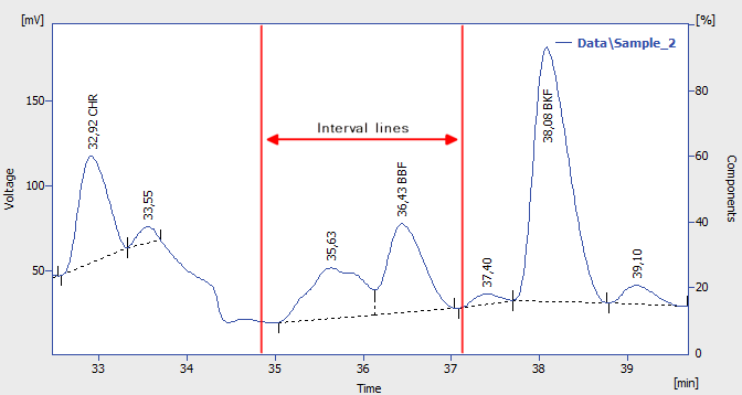

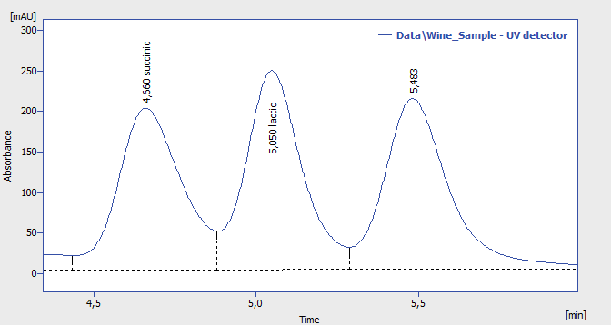

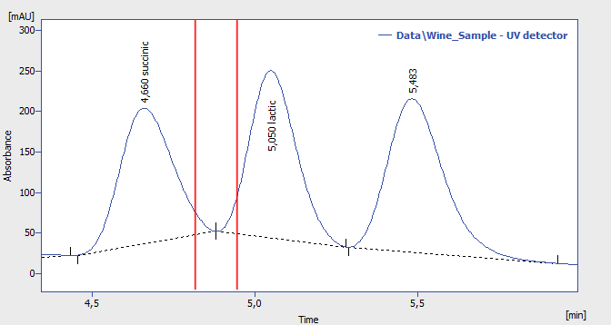

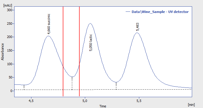

Together
                                            The Together command or
 icon introduces separating verticals to all valleys that are situated between the interval lines. This operation is opposite to the Valley command.
Vertical separations to all valleys

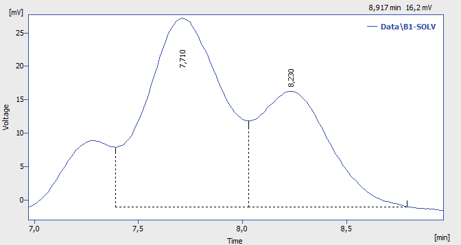

Forward Horizontal
                                            The Forward Horizontal command or
 icon extrapolates the baseline horizontally forwards. In the selected interval, the baseline will proceed horizontally from the first identified peak beginning and will end in a vertical line at the peak end. Should the baseline intersect the signal prior to the peak end, the forward horizontal method may not be applied. The end of the previous peak is then identified before the point of intersection and the station will again attempt to project a horizontal baseline. In this instance extrapolation is understood to proceed from left to right.
Forward horizontal baseline

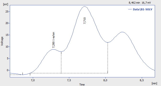

Backward Horizontal
                                            The Backward Horizontal command or
 icon extrapolates the baseline horizontally backwards. The baseline will proceed in the selected interval horizontally from the last identified peak end and will finish in a vertical line at the peak beginning. Should the baseline intersect the signal prior to the peak beginning, the backward horizontal method may not be applied. The end of the previous peak is then identified after the point of intersection and the station will again attempt to project a horizontal baseline. In this instance extrapolation is understood to proceed from right to left.
Backward horizontal baseline

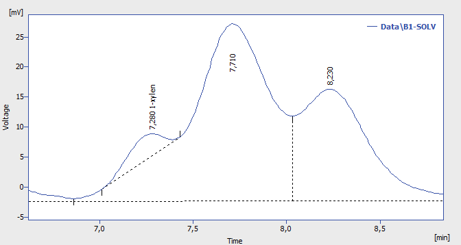

Front Tangent
                                            The Front Tangent command or
 icon separates small peaks on the ascending part of the following larger peak by what is known as the tangent skimming method. Place the left interval borderline before the peak you still wish to separate and place the right interval borderline inside the fronting peak from which you wish to separate the rider.
Front tangent

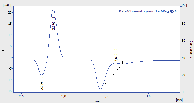

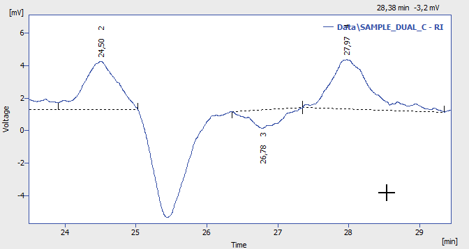

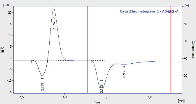

Clamp Negative
                                            The Clamp Negative command or
 icon modifies the interpretation of the signal inside the specified interval by creating positive peaks from a group of negative ones inside the region (the original apexes then become valleys and vice versa). This works only for at least partially unresolved peaks, totally resolved negative peaks in the interval will just be eliminated (no positive peaks will be created).
Clamp negative

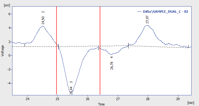

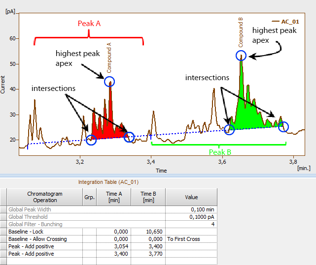

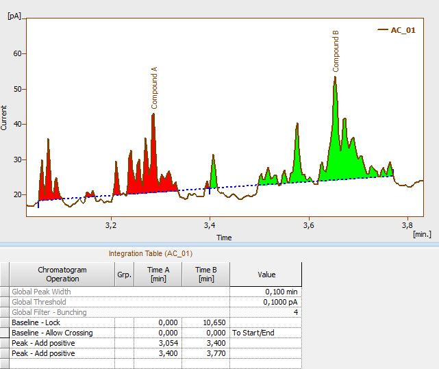

Allow Crossing
                                            This function (icon
) allows the baseline crossing with the signal line inside a specified time interval. In this Allow Crossinginterval Clarity doesn't check if the peak starts and peak ends cross the baseline. If the peak starts and ends were automatically moved by Clarity due to not to cross the baseline then with the Allow Crossing option set these automatic peak starts and ends moves are discarded further manual moves of peak starts and peak ends will ignore the crossing.

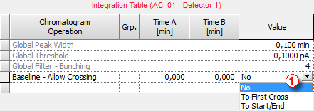

When selected it is possible to set up its application to the current chromatogram through Integration table where one of three options can be selected by clicking arrow ①. Note when setting Time A and Time B equally to 0.000 min will result in application of Allow Crossing for the whole chromatogram and when setting Time A and Time B with different values it will result in application of Allow Crossing only within set time window. Time A value has to be lower than Time B value.
Allow Crossing Setting
Switches Allow Crossing option off meaning the integration will take place like there is no Allow Crossing selected.
Peak area will be considered only the part of the highest peak, bordered by first intersection of the signal line and the baseline to the right and left next to the highest peak apex. For better understanding see following two images. Pay an attention to different highlighted areas of peaks with respect to different settings of time intervals of individual rows in the Integration table.
This function finds the highest peak apex and locates the crossings of the signal with the baseline to left and right. The resulting area will be considered as the peak area.
To First Cross
As a peak area will be considered all parts of signal line above baseline inside the selected time interval for allow crossing operation. For better understanding see following image. Pay an attention to different highlighted areas of peaks compared to peak areas highlighted by To First Cross Option.
To Start/End
The Allow Crossing operation will be applied only if there is a detected peak apex within the time interval set for the Allow Crossing.
On the image you can see that:
- On the left the highest apex of a Compound A peak is detected within Allow Crossing time interval.
 - On the right the Allow Crossing time interval (see ②) does not overlap with the highest apex of the Compound B peak. Allow Crossing will not apply to Compound B peak.
Comparison of different time intervals set for Allow Crossing

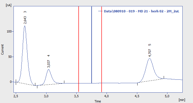

Spike Removal
                                            The Spike Removal command or
 removes spikes in the selected interval and replaces the missing area with a calculated signal line. Usage of this function needs careful placing of the start and end point of the selected interval, as Clarity will replace the "missing" data with a polynomial using the same slope at the start point and the end point as the original signal had. The usage of this function only available in Clarity version 4.0 and higher may be disabled by the use of the Disallow Spike Filter and Spike Removal parameter from the GLP Options dialog (for more details see also chapter GLP Options)
Spike removal
