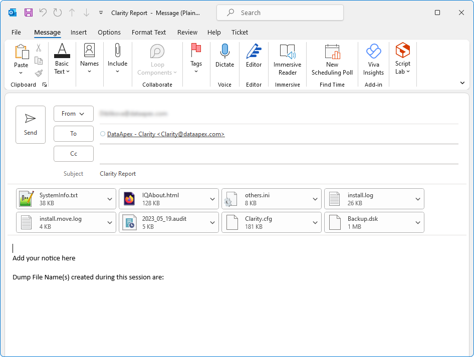

Sends the information on the state of the Clarity workstation to the user help desk of DataApex. Use this command in the case that you have problems with the functionality of the Clarity workstation. The command creates a new e-mail message addressed to our technical support.
E-mail message with information about Clarity
In the appendices are the SYSTEMINFO.TXT, BADTRACE.TXT files, current desktop, current configuration and two last files of the station audit trail. All these files contain information describing the state of the Clarity workstation at the time when the problem(s) occurred.
