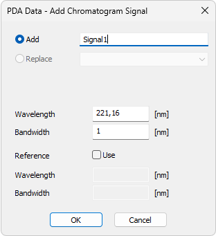

Add Signal
Stores a cut of the PDA data on the selected wavelength/range of wavelengths as a signal in the current chromatogram.
PDA Data - Add Chromatogram Signal
Add
Adds the new signal with the specified name (gained as a cut at selected wavelength) to the chromatogram from which it was created.
Replace
Replaces the selected signal in the chromatogram from which it was created by a new signal gained as a cut at selected wavelength. The Replace signal is not allowed for originally acquired signals, only new signals derived from spectra can be replaced.
Wavelength
Sets the new signal wavelength.
Bandwidth
Sets the bandwidth for the new signal (how much cuts will be taken and averaged to create the new signal).
Reference
If the Use checkbox is checked, the reference signal will be used for eliminating the uneven intensity of the lamp.
The Reference wavelength should be set to the area of chromatogram where no peaks are present, e.g. where no compound absorbs.
Wavelength
Sets the reference signal wavelength.
Bandwidth
Sets the bandwidth for the reference signal.
