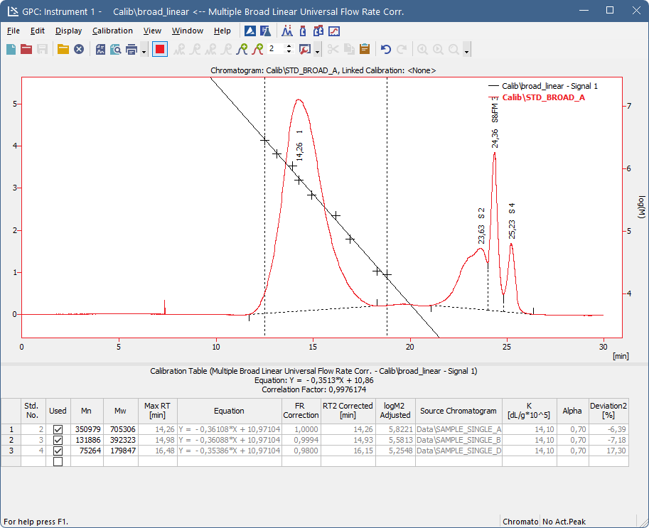

Three points for each peak are used to construct a resulting calibration curve. One point is peak Max RT, the others are computed by Peak Height value entered in the GPC Calibration Options dialog.
GPC Calibration (Broad Linear)
After selecting the calibration type, a standard chromatogram can be opened. The Add Broad Peak
icon will transfer the integrated peak data to the Calibration Summary Table, setting a new standard number and creating a new line for each peak.
For multi-signal standards the Set Broad Peak
icon is used for transferring the peak data on subsequent signals to calibration. Operation is performed only for peaks with Std. No. value equal to current Std. No. indicated on the Window toolbar of the Calibration window.
The last Broad Peak is temporarily remembered and used in subsequent recalculations. Current Broad Peak is indicated in right lower corner of the Calibration window.
