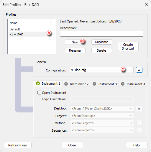

  3. In the Edit Profiles dialog, click the New button to create a new profile and name your profile (e.g. RI + DAD). Click OK to save the profile. Newly created profile is displayed in the small table on left .
  4. From the drop-down list , select Clarity.cfg, click the button, from the selection choose Duplicate and in the following dialog name your configuration (e.g. ri+dad.cfg).
    This step will create a duplicate configuration (.cfg file) based on the current Clarity setup (as described in step 1.). It prevents Clarity from overwriting a default configuration.

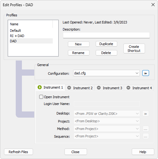

  1. Create a new profile (DAD) with a different configuration (duplicated ri+dad.cfg named as dad.cfg), similarly to steps 4.-5. Once done, your profile should look similar to the image below.

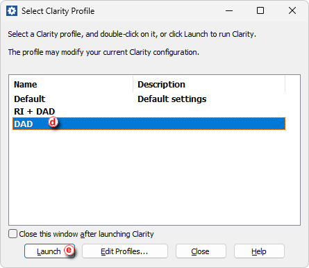

  2. In the Launch Manager window select the DAD profile which has not been configured but simply duplicated and click on the Launch button.

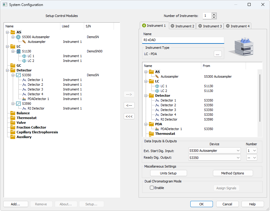

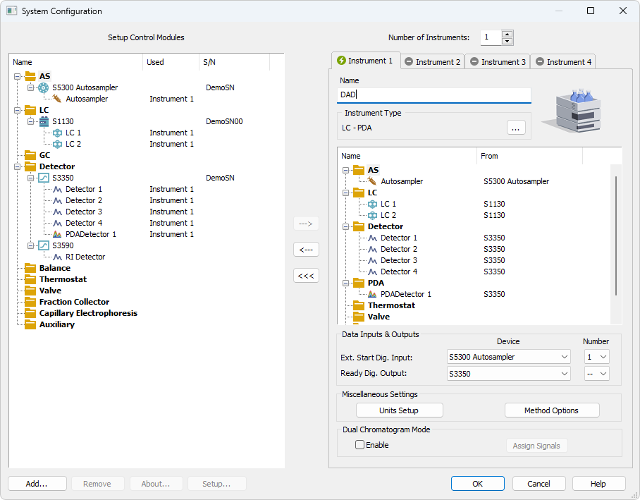

  1. Clarity has launched with the selected profile, open System Configuration. Since the configuration has been duplicated from the initial configuration, both detectors are present. Remove the RI detector from instrument and save the configuration by click OK in the System Configuration window.
  2. Note:
    This step may differ based on used control modules. In our case simply drag the RI module from right side to the left one. In other modules e.g., when using ICF you have to invoked the control module setup and change it there.
