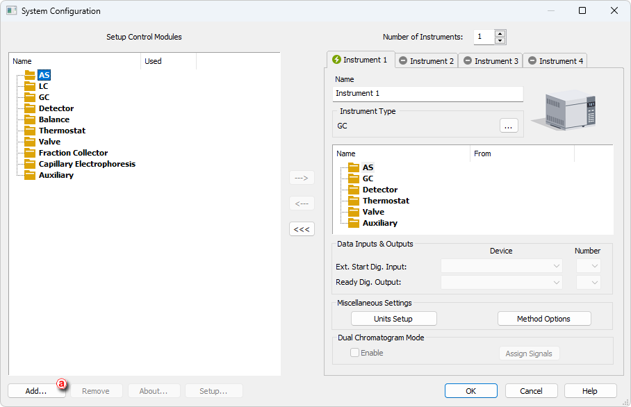

  1. Enter the System Configuration dialog: select System - Configuration… on the Main window.

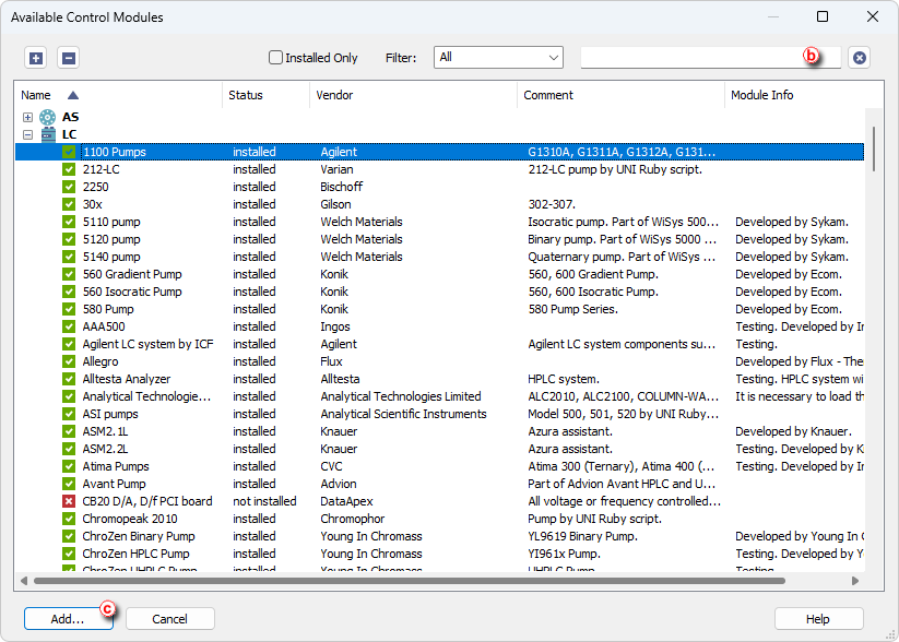

  1. If the device you want to add is not in the list, click on Add and the following window will open. Here you can filter the list by typing some text in the filter field or filter by Name, Vendor, etc .
    If the status of the module is not installed, double-click the line with this device to see why the module is not installed and how to remedy the situation.
  2. Select the device and click on Add or double-click the line.

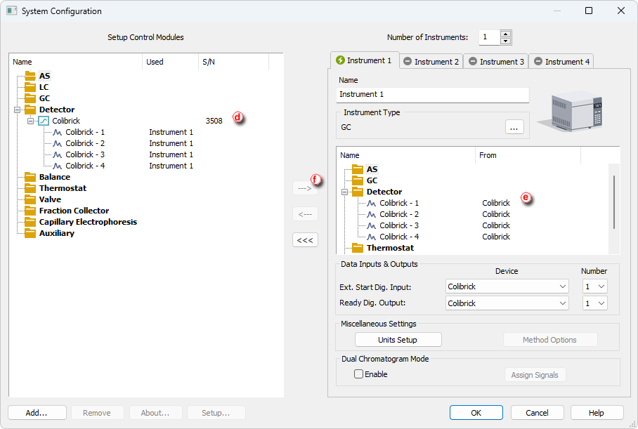

  1. Add new devices to the appropriate instrument: drag and drop the device from the left pane to the Instrument pane on the right or select the device and click on .
  1. If you need to help with configuring a device, go to the topic Configuring a device.
