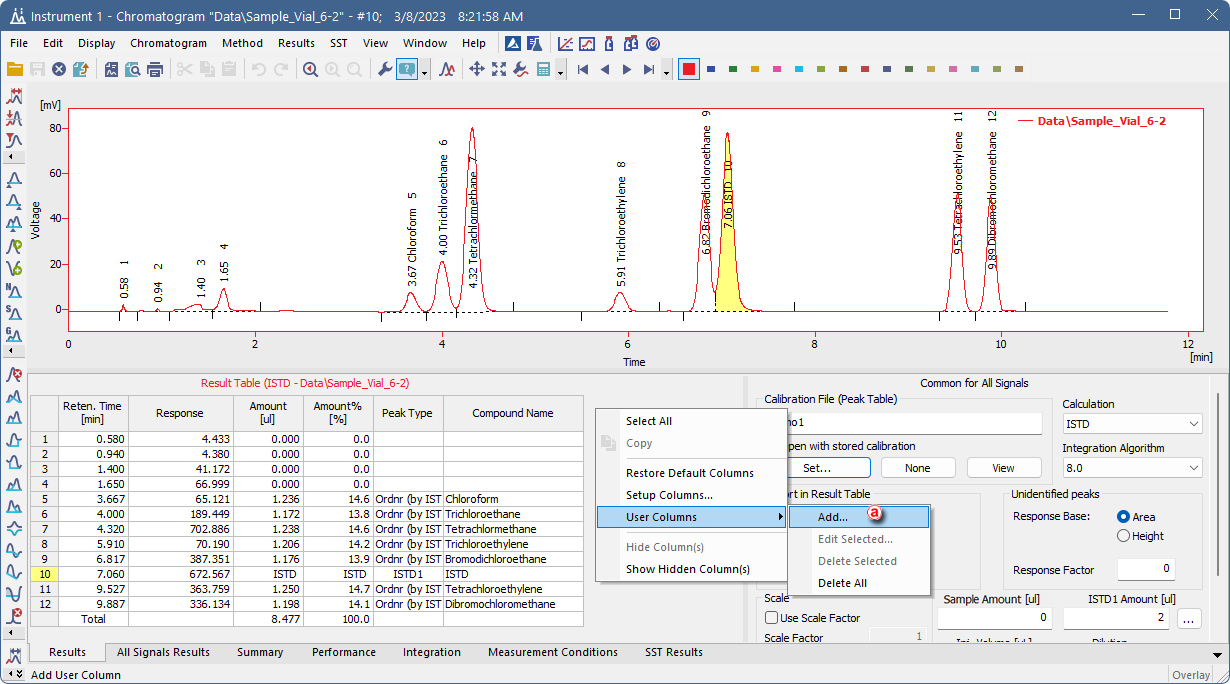

  1. Open a chromatogram you want to work with and switch to Results tab.

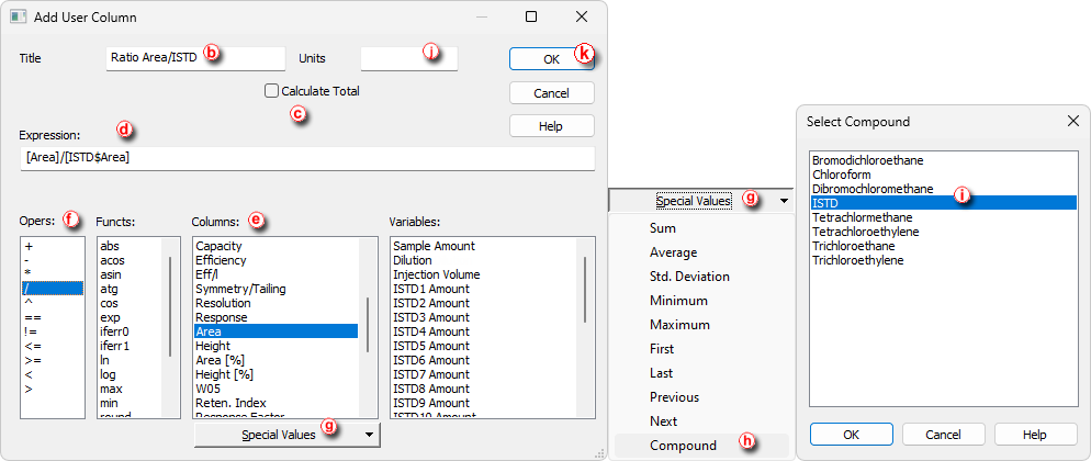

  2. Right click on the Result Table and select User Columns - Add... , the Add User Column dialog will be opened.
  1. Fill in the Title of the new column. In our case Ratio Area/ISTD.
  2. Check/Uncheck Calculate Total (depends on whether sum of calculated values has a meaning).
  3. Fill in Expression line , which presents the user's defined calculation. In our case:
    • In Columns: list double-click Area.
    • In Opers: list double-click /.
    • In Columns:list select Area, then click on Special Values , select Compound , choose ISTD and click OK.
  4. Fill in appropriate Units based on the formula.
  5. Click OK in the Add User Column dialog.
  6. Note:
    It is possible to fill Expression by typing if you know the correct syntax.

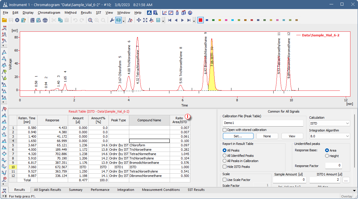

  1. New User Column is added to the Result Table .
You can edit existing User Columns by right-clicking into them and selecting User Columns - Edit Selected....
