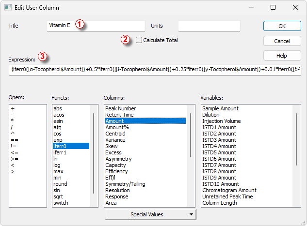

  1. Open a chromatogram you want to work with and switch to Results tab.
  2. Add a User Column as described in chapter "User Columns".
  3. Fill the Title for the new column - e.g. Vitamin E ①.
  4. Uncheck Calculate Total ②.
  5. Enter the formula for calculating the vitamin E content, e.g., "([α-Tocopherol$Amount]+0.5*[β-Tocopherol$Amount]+0.25*[γ-Tocopherol$Amount]+0.01*[δ-Tocopherol$Amount])/10" to the Expression field. You can either use items from the Columns: list with Special Values or type it manually.
  6. Apply the iferr0 function on the items that may be missing from the result table. The resulting function will look like the following: (iferr0([α-Tocopherol$Amount])+0.5*iferr0([β-Tocopherol$Amount])+0.25*iferr0([γ-Tocopherol$Amount])+0.01*iferr0([δ-Tocopherol$Amount]))/10 ③.
  7. Close the dialog by clicking OK.

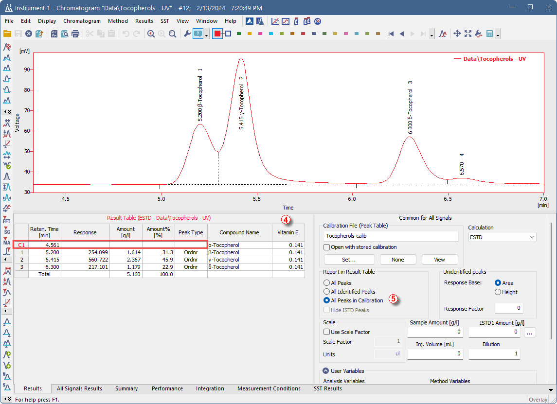

  1. The new Vitamin E column ④ is displayed in the Result Table.
  2. In the case that any of the compounds is not found in the chromatogram (such as here, in the case of α-Tocopherol), the Amount is not calculated. The iferr0 function replaces the not-found Amount with zero in further calculations.
Note that the All Peaks in Calibration ⑤ option is selected. Otherwise, the missing compound would not be present in the Result Table, and the calculation would not be possible.
