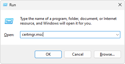

  • In Microsoft Windows, press the windows + R to open the Run dialog. Type "certmgr.msc" in the dialog and click OK.

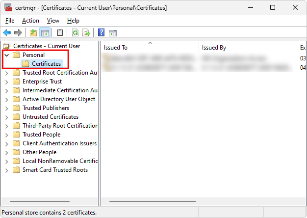

  • In the following window, navigate to Personal folder. Such folder contains certificates that are detected by Clarity, which can be later selected in the Select certificate dialog in the User Accounts window.
