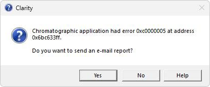

Report error after Clarity crashed
Send Report dialog
If Clarity encounters a serious problem and crashes, it will invoke a dialog during the crash that offers to report the problem to DataApex. Such reports help us locate the conditions leading to crashes and fix the faulty behavior accordingly.
However, in some cases, Clarity may crash without producing any message. In such cases, a similar error message is prompted at the next start of the Clarity station.
More details about sending an e-mail report can be found in the chapter "Send Report by E-Mail".
