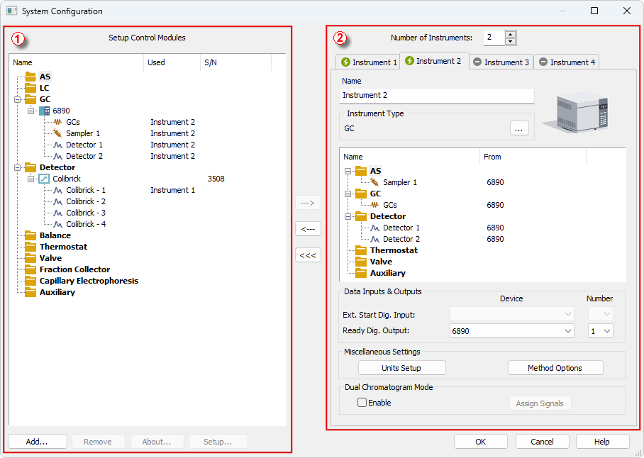

System Configuration - left side System Config - right side
Serves for the setting of the station’s configuration, which is saved in Clarity.cfg file.
After prompting the System - Configuration… command or pressing the icon, the System Configuration dialog will be opened. Access to the System Configuration dialog is permitted only to users with adequate access rights settings. Access is also denied if any of the Clarity Instruments is not closed (you will be prompted to close opened Instruments).
The left section of the dialog ① is used to configure equipment in the Clarity station, while the right section ② is where the equipment is allocated to individual Instruments.
