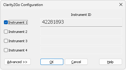

How to set it up:
  • Check the checkbox of Instrument 1..4 you want to monitor.After successful registration every checked Instrument will get its unique ID, displayed right to the name of the Instrument.
  • Enter this ID into Clarity2Go client on your smartphone to access it for monitoring.
Clarity2Go Configuration dialog
Instrument 1…4
Turns On/Off the sending of the status of particular Instrument. When Instrument is not registered, checking this checkbox will connect Clarity2Go server and register the Instrument.
Advanced/Basic
Show/Hide advanced settings, which has no use for most users.
Close
Close the Clarity2Go Configuration window.

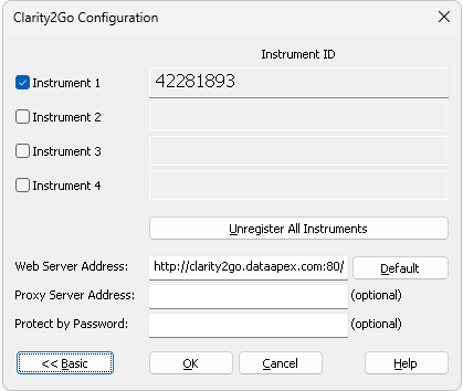

Clarity2Go Configuration - Advanced dialog
Unregister all instruments
Unregister all registered Instruments on Clarity2Go server.
Web server address
Set the address of Clarity2Go server.
Default
Set the default address of Clarity2Go server.
Proxy server address
When proxy server is used for connecting the Internet, set its address.
Protect by Password
By entering a password here, protection is enabled and the same password needs to be filled in on a mobile client.
