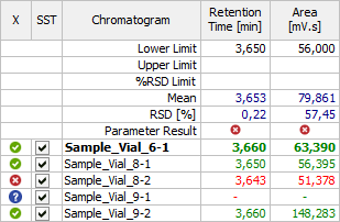

Summary table of validated chromatograms
In the summary table of validated chromatograms, one can easily and quickly determine if a chromatogram is deviating out of line.
The procedure for setting the SST method is the same as in the chromatographic system validation (for more details see also chapter Validation of the chromatographic system)
The Overlay mode in the Chromatogram window must be enabled.
In the parameters table you can set limit values for the measured results to comply with.
Only the List of chromatograms in the Parameters Table and icons to the left of it are relevant. All other results (overall validation result, results in the Component Table, as well as results in the Parameters Table - above the bold line) refer to the chromatographic system validation.
