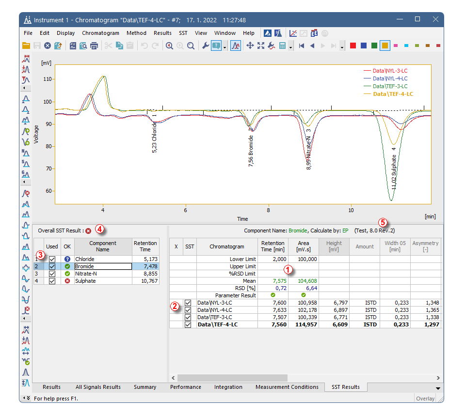

Chromatogram - SST Results
The SST tab in the Chromatogram window contains two tables used for setting the validation parameters - Component Table (on the left) and Parameters Table (on the right) of a selected component.
Tables in the SST Extension use graphical symbols depicting the validation result at four different levels: on the level of individual parameters ①, chromatograms ②, components ③, or the overall ④ success of the validation. Symbol meanings are as follows:
Validation result symbols
| Symbol | Meaning |
Validation was successful. |
Validation could not be run (e.g. no parameters specified) - validation result unknown. |
Validation was unsuccessful. |

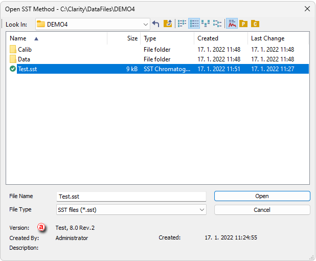

Version of Integration Algorithm is displayed next to SST Method name ⑤. It is also displayed in the file open dialog ⓐ invoked by clicking SST - Open....
SST - Open... dialog
