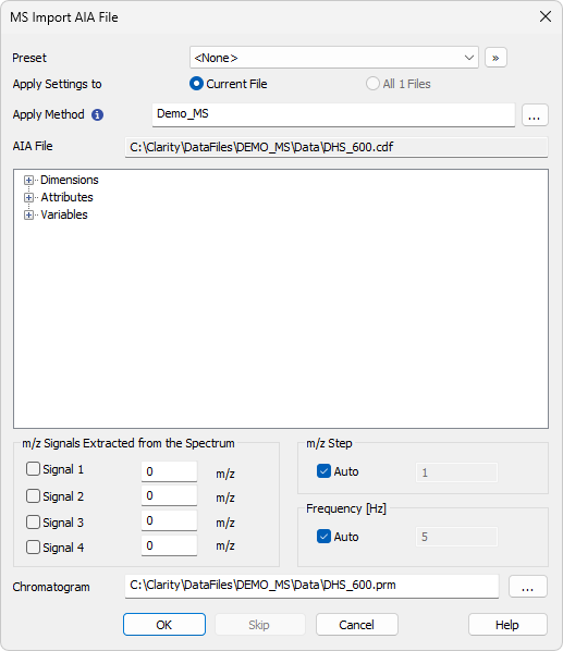

MS Import AIA File
MS Import AIA File dialog
Preset
Allows to select a preset from the list of stored import presets. A preset can be created / deleted / managed using the button.
Apply Setting to
Radio-button deciding whether the settings for the import will be applied just to Current File selected (the one as defined by the AIA File/File field) or to All n Files selected for import (if multiple are selected). The setting for multiple files is applied to all files imported using the same import dialog (as technically user can select multiple files to import that are exported to different format).
Apply Method
Choose method whose parameters (integration table, attached calibration, etc.) will be applied into the imported chromatogram. By default, displayed method matches method in the Single Analysis dialog. Leaving this field blank applies default parameters.
AIA File
Name of the imported file including directory path.
AIA file content preview
Pane that displays the content detected inside the active *.cdf file to import. The file must contain one or more spectral data and may also contain one or more signals, stored in separate structures. Clarity displays the data divided into Spectra and Signals sections, and offers the preview on parameters of the data and/or few first data points.
The *.cdf file which does not contain at least one spectral data structure will be imported through Import AIA File dialog instead.
Signals extracted from spectra
Defines which signals should be extracted from the spectral data and stored to the chromatogram as standard signals. A chromatogram in Clarity must contain at least one standard signal (on top of possible spectral data), so this section allows to create such signal(s) in case the *.cdf file does not contain any. Alternatively, even when the *.cdf file contains such signals, additional signals can be created through this section. If there are multiple spectral data in the *.cdf file, the section also allows to define from which spectral data the particular signal will be created.
The TIC (Total Ion Current) and/or BPI (Base Peak Intensity) signals can be created only from particular spectral data selected or from every spectral data available in the *.cdf file. Up to four additional signals are possible, with the m/z precision being limited by the m/z Step value of the chromatogram. If the specified m/z value is outside the measured spectrum in the imported chromatogram, the import will not be possible.
m/z Step
Defines the precision of the m/z values being imported, set in amu (atomic mass unit) or Da (Dalton). While the Auto checkbox is checked, the import mechanism will try to read the m/z step value defined in the data (if it is defined there) or decide the optimal m/z Step itself, unchecking it allows the user to select the desired value. Setting the value manually too low will create unnecessary larger data, while setting it too high will cause a loss of m/z precision.
Frequency [Hz]
Defines the sampling frequency of the spectral data being imported. While the Auto checkbox is checked, the import mechanism will decide the optimal frequency itself, unchecking it allows the user to select the desired value.
Setting the Frequency too low manually will create chromatograms with less-than-ideal data points and distorted peak shapes. Setting it too high will create artificial points where the real ones are missing. These artificial points are generated as a linear interpolation between existing points.
Import non-equidistant data
Clarity only works with chromatograms that use equidistant data point spacing. This option allows to import the non-equidistant data as well. The data will be interpolated to equidistant during the import. Please note that MS chromatograms exported to *.cdf files from Clarity before version 10.2 did not contain the equidistant data flag so will need to use this option.
Chromatogram
Name and location of the resultant chromatogram created after importing the spectral file. By design, the program will store the original name of the imported file along with the *.PRM suffix and the path to the directory of the current project.
To select another name and location of the resultant chromatogram, open the Save As... dialog using the button.

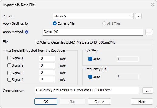

Import MS Data File
Import MS Data File dialog
Preset
Apply Setting to
Apply Method
File
m/z Signals Extracted from the Spectrum
Defines which signals should be extracted from the spectral data and stored to the chromatogram as standard signals. Up to four signals are allowed, with the m/z precision being limited by the m/z Step value of the chromatogram. If the specified m/z value is outside the measured spectrum in the imported chromatogram, the measured value closest to this value is used instead.
m/z Step
Defines the precision of the m/z values being imported, set in amu (atomic mass unit) or Da (Dalton). While the Auto checkbox is checked, the import mechanism will decide the optimal m/z Step itself, unchecking it allows the user to select the desired value. Setting the value manually too low will create unnecessary larger data, while setting it too high will cause a loss of m/z precision.
Frequency [Hz]
Chromatogram
