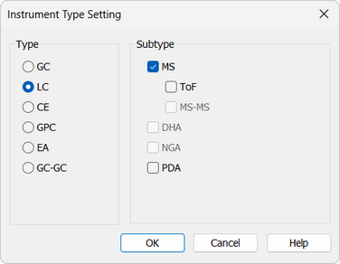

To enable the MS Extension on an Instrument, you have to set the corresponding instrument type. To set the instrument type, click the button in the System Configuration dialog.
In the invoked Instrument Type Setting dialog, select the GC-MS or LC-MS option.
