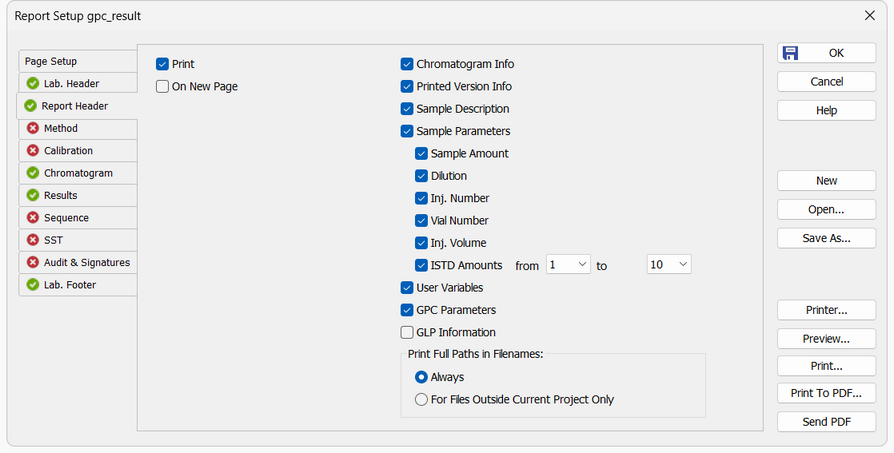

Report Setup - Report Header
Report Setup - Report Header (GPC)
GPC Parameters
GPC Parameters checkbox adds Mark–Houwink parameters to the printed report.
The reported values correspond to the K & Alpha parameters defined in the Common for All Signals section of the GPC Results tab. These parameters are used for molecular weight calculations and are stored with the chromatogram.
