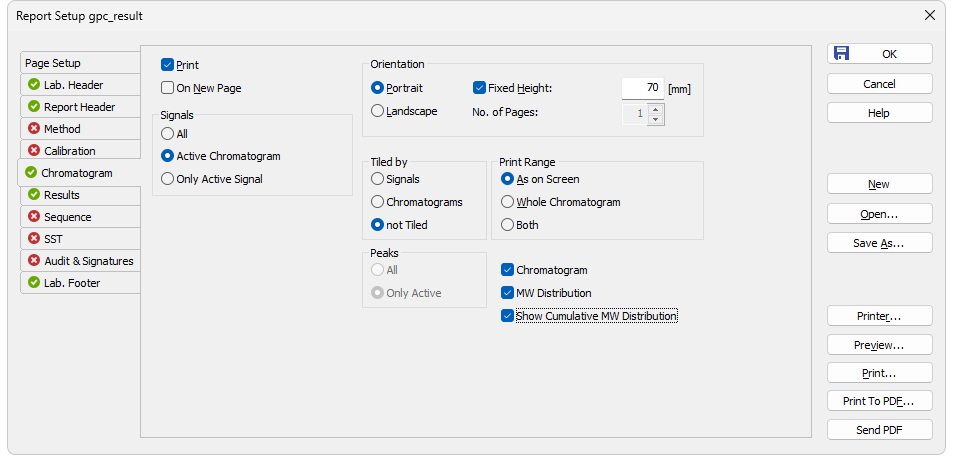

The printing of Chromatogram, MW Distribution or Cumulative MW Distribution can be individually selected by the appropriate checkboxes. All graphs are printed using the common Orientation settings.
The Peaks area will only be active if the Tiled by - Signals option has been selected. It will then print the MW Distribution and Cumulative MW Distribution graphs for all or only for active peak in each signal.
Other options are the same as in standard mode (for more details see also chapter Chromatogram).
