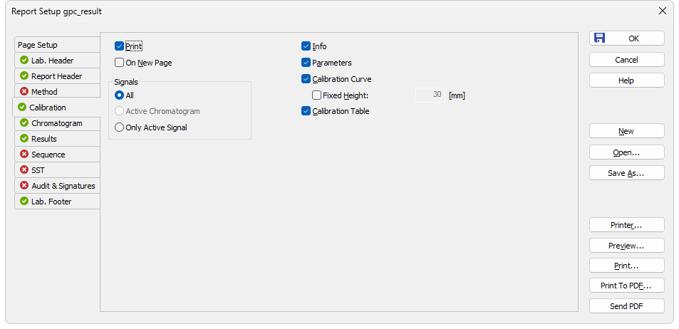

Report Setup - Calibration
Report Setup - Calibration (GPC)
Calibration Curve
Prints the calibration curve displayed in the Calibration window.
Fixed Height
If the Fixed Height checkbox is checked, the chromatogram will be printed with a fixed height instead of the fixed ratio 2:3. The permitted lower height range is 30 mm, the upper height range is not set - the graph will be scaled to the page height if larger than the page itself.
Calibration Table
Prints the Calibration Summary Table. This checkbox is equivalent to the Summary checkbox on the standard Report Setup - Calibration tab.
Other options are the same as in standard mode (for more details see also chapter Calibration).
