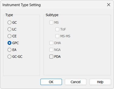

To enable the GPC Extension on an Instrument, you have to set the corresponding instrument type. To set the instrument type, click the button in the System Configuration dialog.
In the invoked Instrument Type Setting dialog, select the GPC or GPC-PDA option.
The given Instrument may be later switched between the GPC mode and standard chromatography mode using the Setting - GPC mode menu command in the Instrument window.
