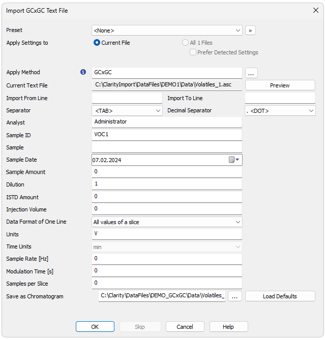

After selecting the chromatograms in the Open Files to Import dialog and pressing the Open button, the Import GCxGC Text File dialog opens.
The conversion program determines the most suitable import setting according to the content of individual imported text files. Individual settings can subsequently be adjusted in the Import GCxGC Text File dialog and saved for further use. Import is performed by the OK button.
If a number of files was selected in the Open Files to Import dialog, a further Import GCxGC Text File dialog or Import AIA File dialog will open (according to the type of the next selected chromatograms) after clicking on the OK button.
When the same type of files are imported frequently, it can be useful and time-saving to save import settings for further use. In drop-down box on the left user can select from previously saved presets, by clicking
button right to list the presets management menu will open. The menu contain commands for saving current setting (Create New...), Rename... or Removepresets. Presets are stored as part of Clarity Desktop settings.
This radio button group indicates whether all the settings below will be applied either to current file only or to all files imported at once. In case multiple files are imported at a time, and this radio buttons are set at Current File, the Import Text File dialog will be invoked for every file in the sequel. When Apply Settings to radio button is switched into the All n Files position, subsequent files will be proceeded with the same settings. By checking Prefer Detected Settings checkbox you can force Clarity to use setting detected from the imported file (where applicable).
Choose method whose parameters (integration table, attached calibration, etc.) will be applied into the imported chromatogram. By default, displayed method matches method in the Single Analysis dialog. Leaving this field blank applies default parameters.
The name of imported file including directory path.
This button will open the current file in simple text viewer. This can help user to identify exact meaning of particular columns when it's not clear from file suffix.
Sets the line of the file on which the data import should start.
Sets the last line of the file that should be imported.
Selects the sign by which the individual items are separated in the text file. <TAB>, <SPACE>, <COMMA> or <SEMICOLON> are available signs to choose from.
Separator of decimal points - <DOT>, <COMMA> or <Windows Locale>. Separator indicated in Windows (as <Windows Locale>) is used as the default.
Parameters entered to Import From Line, Import To Line, Separator and Decimal Separator fields will be applied on all simultaneously imported chromatograms.
Analyst, Sample ID, Sample, Sample Date, Sample Amount, Dilution, ISTD Amount, Injection Volume
These fields composing the chromatogram heading have the same meaning as described in the chapter "Single Analysis"
Selects the sampling speed in the number of samples per second (Hz).
Enters the time of modulation (i.e. an interval of one slice).
Enters number of samples per slice (i.e. per one modulation).
To successfully import GCxGC Text File, at least two parameters have to be entered to the above mentioned fields (i.e. Sample Rate, Modulation Time and Samples per Slice) or have to be included already in the chromatogram heading. The third parameter will be checked (if entered) or will be calculated automatically (if not entered).
Sets the name and location of the resultant chromatogram created after importing a text file. By default, the program will offer to use the original name of the imported file using the suffix *.PRM with a path to the directory of the current project.
To select another name and location for the resultant chromatogram, open the Save As... dialog using the
button.
Selects implicit values of all fields (i.e. returns the dialog into state prior to any changes made after opening).
OK
Confirmation of import.
Skip
Skips current file and proceed to subsequent one while importing multiple files.
Cancel
Cancellation of import.
