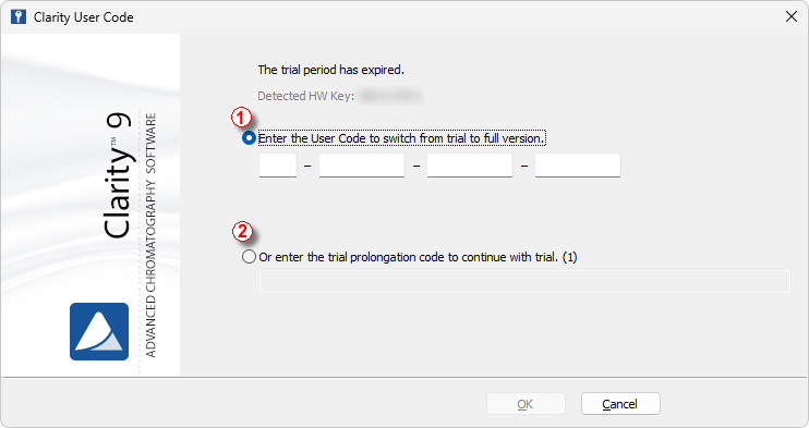

Trial Expired error dialog
The Trial period (time period when Clarity works without a User Code filled in) expired. You are prompted to enter a User Code or a Trial Prolongation Code.
▌Reason: Your Clarity station just ended its trial period.
Solution:
a) Enter the correct User Code, which switches Clarity from the Trial mode into the full mode .
b) Or switch to section and enter a Trial Prolongation Code to extend the trial mode period. Trial Prolongation Codes must be requested from your distributor or DataApex.
Once a correct User Code or Trial Prolongation Code has been provided, click the OK button to start Clarity.
Clarity User Code dialog
