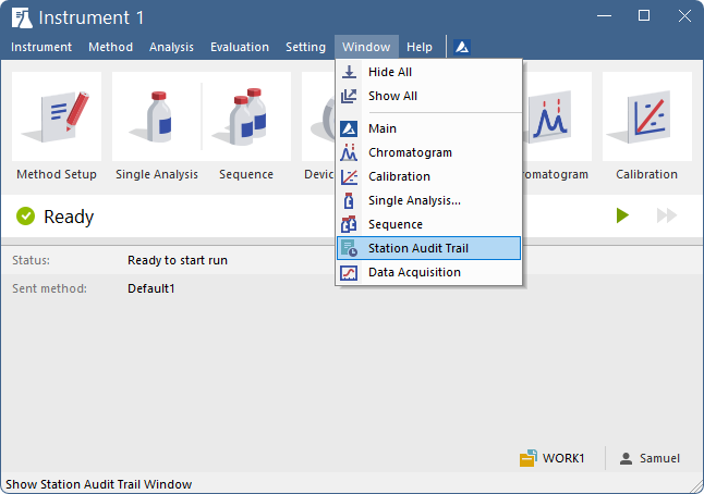

  1. Select Window - Station Audit Trail from the Instrument, Chromatogram, Calibration, Sequence or Data Acquisition windows. Alternatively click icon in the Main Station window.

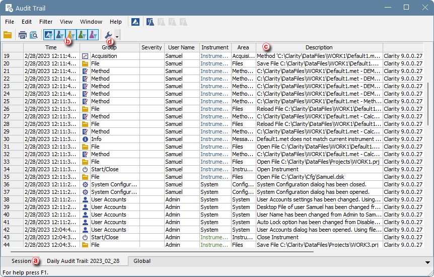

  1. Click on the Session tab if you would like to see the log from the time Clarity was started or on the Daily Audit Trial tab for the present day events.
  2. Note:
    The Daily Station Audit Trail is stored in one separate file every day the station is running. These files can be opened by using the command File - Open Audit Trail (Append).
  3. Click on the Instruments or System icons to filter out events and operations based on instrument where they occurred.
  4. Inspect the Description column to find out about operations and events that have taken place .

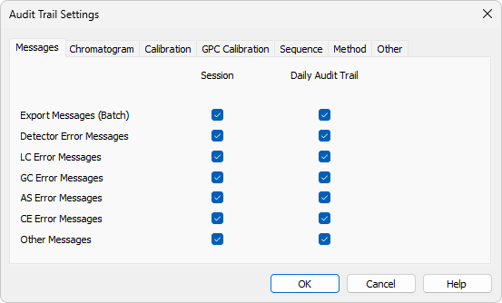

  1. Click on the Properties icon to set up which events and operations should be recorded in the Session or Daily Audit Trail.
