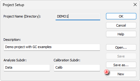

  1. To create new project navigate to the Project Setup dialog by selecting Instrument - Project... in the Instrument window.
You can also open a project through the Login Dialog opened from the Main Clarity window by selecting the New Project option and clicking OK.
  1. In the Project Setup dialog click the New button to create a new project.

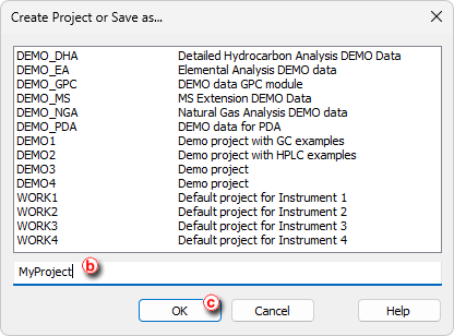

  1. Set the name of the new project and click OK .
Entered project name must not contain invalid characters, i. e. \ /:*?"< >|.

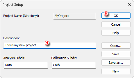

  1. Fill in the project description in the Description field and click OK .
