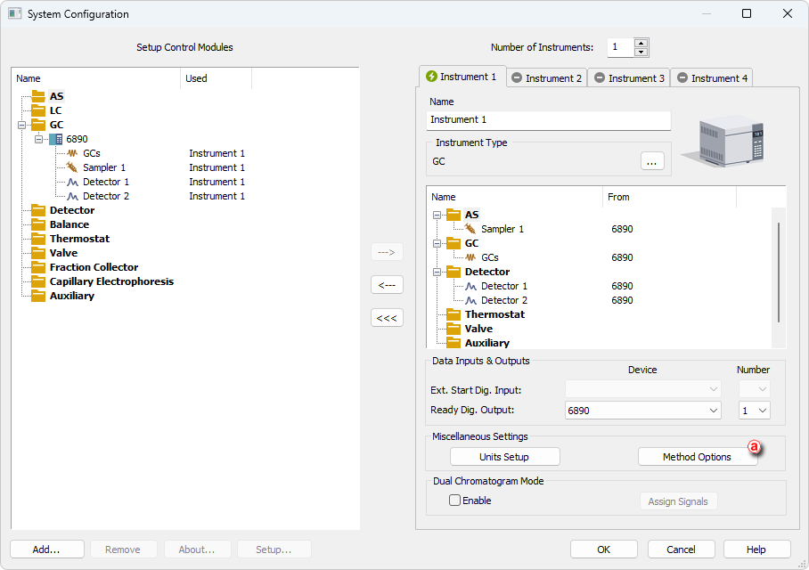

- Enter the System Configuration dialog: select System - Configuration… on the Main window.
- In the group Miscellaneous Settings click on Method Options button ⓐ.

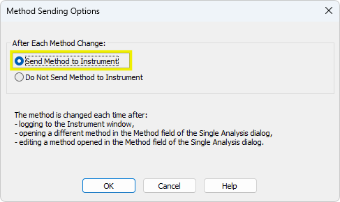

- Choose one of the option of the method sending.
If you select the Send Method to Instrument option, the method selected in Single analysis window will be sent every time you log into the instrument or this method is modified, or when the sequence is finished.
