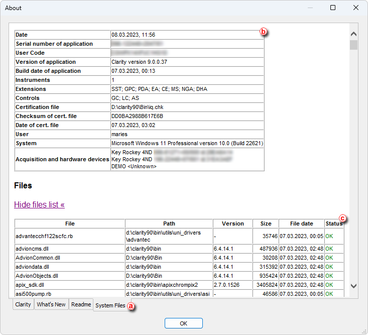

To find out information on the supported control modules and Extensions, used A/D converters and purchased Instrument licenses follow this procedure:
- Open the About box: Select Help - About… on the Main window.
- Switch to the System Files tab ⓐ. Note that it may take a while for Clarity to generate the report.
- In the first table ⓑ there is info about:
	            - Clarity SW version
- Number of purchased instrument licenses
- Extensions available
- The allowed control modules
- Acquisition and hardware devices
- Go to the files table ⓒ to find information about the drivers and its status.
If the status is other than OK there may be an issue with the driver. The version of the drivers developed by DataApex should be the same as that of Clarity.
