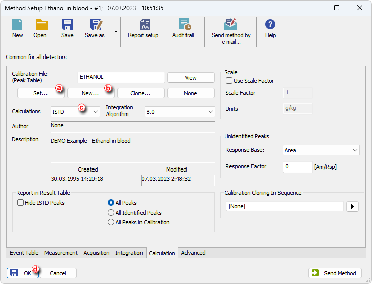

  1. Open the method from the Instrument window by using the Method - Method Setup command.
  2. Go to the Calculation tab.
  1. Click the Set… button ⓐ to select a calibration file for the method, or create a new calibration file by clicking the New… button ⓑ.
  2. Change the default calibration type in the Calculations field ⓒ.
  3. Click OK ⓓ to save the changes to the opened method.
  4. You can modify the calibration file after acquisition. For more info go to Apply the calibration to a Chromatogram.
