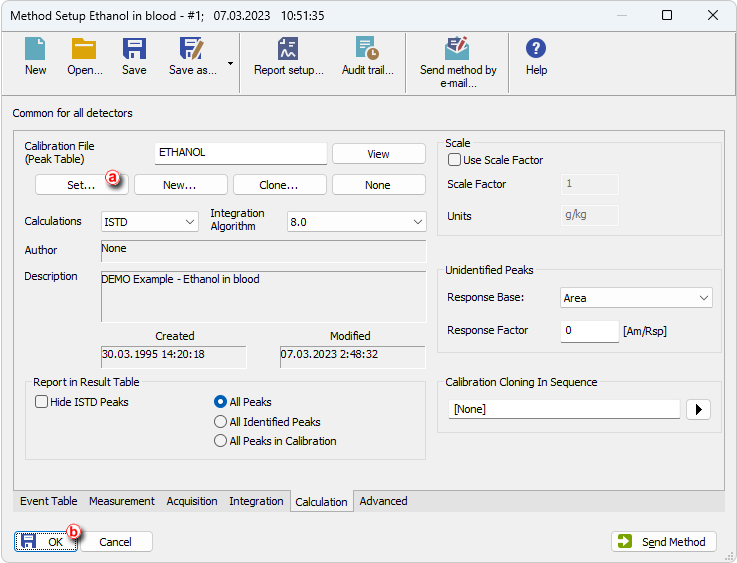

- Open the method file: use File - Open Method… on the Instrument window or click in the Method Setup dialog.
- Go to the Calculation tab.
- Connect the calibration file to the method by using the Set… ⓐ button.
- Save the method file - click OK ⓑ or select File - Save Method or click .

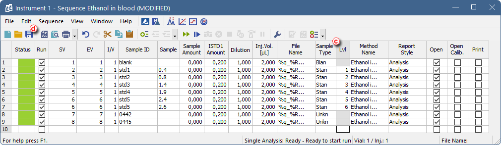

- Open the Sequence window: select Analysis - Sequence or click in the Instrument window.
- Fill in the Sequence Table as described in the section Run a sequence.
- For the calibration standards, fill in the Sample Type and Lvl columns ⓒ in the Sequence Table.
More
The Sample Type column for the calibration standard should be set to the Standard value, the Lvl column for each standard must have a value between 1 and 20. For a blank sample, select Blank in the Sample Type column.
- Save the sequence file: select File - Save or click . ⓓ
The file is now prepared so that the calibration standards measured according to their sequence rows will automatically recalibrate the calibration file.
