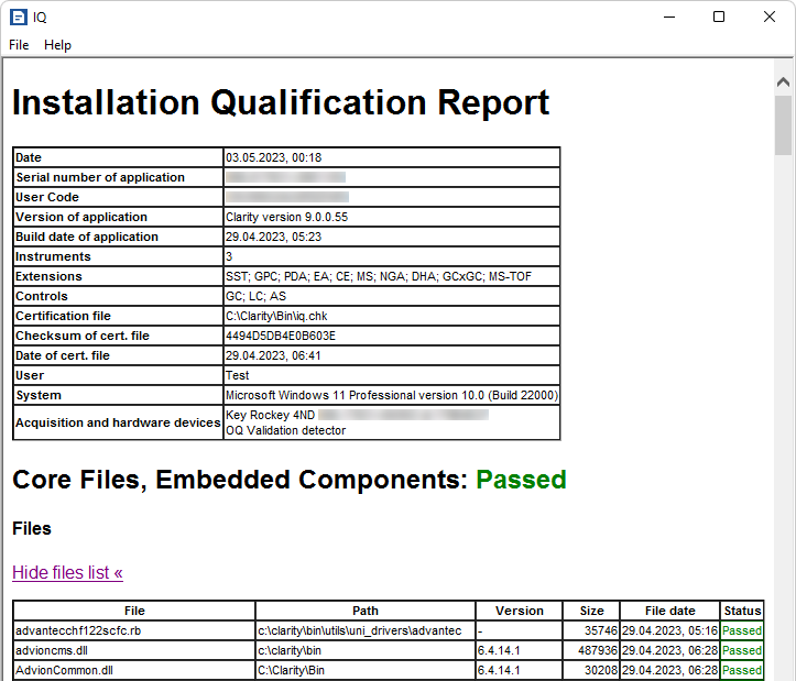

  • Start IQ from the main Clarity window using Help - IQ Report command.
  • If the installation has been performed correctly, the status should read: "Installation Qualification Test: Passed".
The IQ window
  • If the Installation Qualification fails, it is recommended to uninstall using Uninstall.exe and then re-install Clarity. If it fails again, contact the DataApex support (support@dataapex.com).
