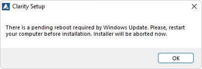

  • Ensure that Windows is up-to-date. In case there are pending Windows updates, Clarity installation will be terminated with the following message:
Pending Windows Update message
