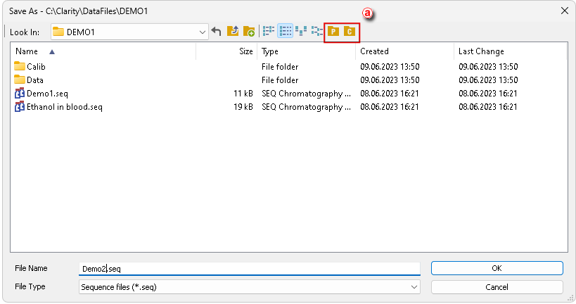

This is a universal dialog for saving files where the new name can be entered or a new directory selected. As it differs somewhat in appearance from the standard window for file selection of the Windows operating system, it is described in more detail below.
Save As Dialog
Icons in the upper right corner ⓐ serve for quick navigation through useful folders, e.g. Data, Calib, Common. What folders are shown here depends on the currently opened dialog, as stated in the following table:

There are some other Save As dialogs, which do not contain any of the specified icons in the right upper corner ⓐ.
