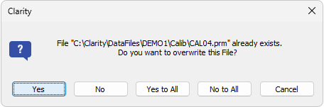

The proper command for restoring (copying or moving) the selected files. A warning dialog is shown if files with identical names exist in the target directory.
Warning message when the filename already exists
