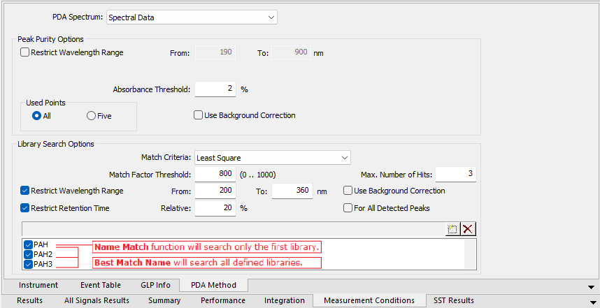

Measurement Conditions
The Chromatogram - Measurement Conditions dialog contains additional PDA sub-tab with PDA-related parameters of the chromatogram.
Chromatogram - Measurement Conditions - PDA
The individual items correspond to the items set in the Method Setup - PDA Method dialog. The Method Setup - PDA Method tab displays the parameters of the template method that will be applied to new chromatograms, while the Chromatogram - Measurement Conditions - PDA tab displays the PDA method of the selected chromatogram.
When opening chromatogram with PDA signals on a non-PDA instrument the Chromatogram - Measurement Conditions - PDA tab is not displayed. Detector's tabs are not loaded, therefore detector's settings, including signal wavelenghts, are not visible.
