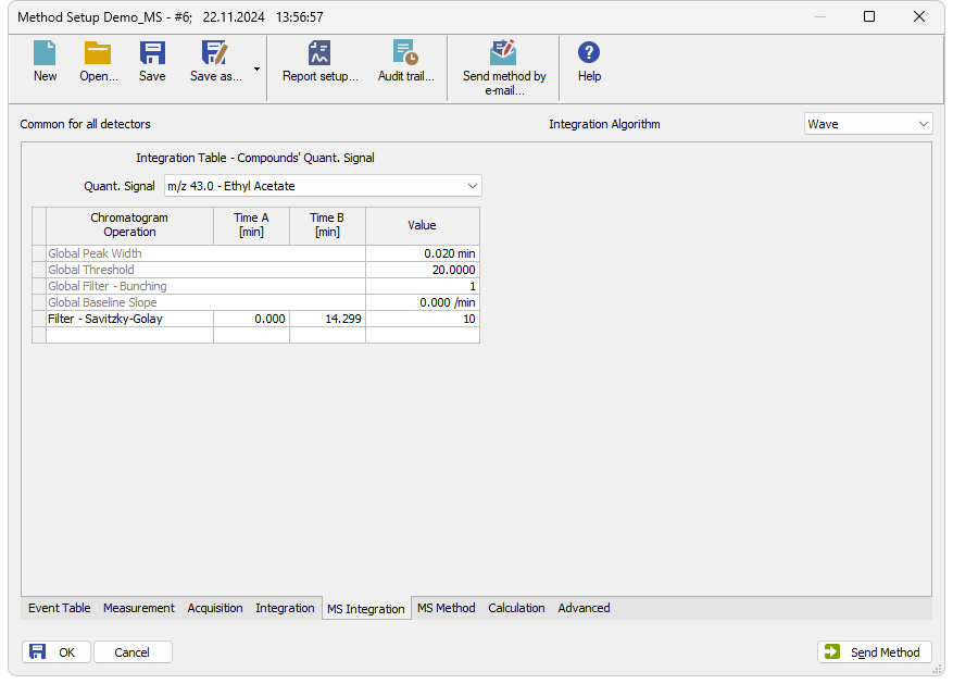

The MS Integration tab shows Integration Table for compound's quantification signals, the most important signals for evaluating the result in the MS Extension.
The Integration Table is unique for each quantification signal. When more compounds use the same quantification signal, such signal is shared among them. For example, having compound A and compound B quantified on the same m/z value means, that changing Integration Table for one of them results in the same changes for the second one.

This information is important in understanding which parameters can be changed just for one quantification signal and which will influence all quantification signals.
In MS Extension integration operations Global Threshold, Local Threshold or Min. Height are displayed in the Integration Table and logged in audit trail without unit, whereas integration operation Min. Area is displayed in the Integration Table and logged in audit trail with time unit only - [.s].
