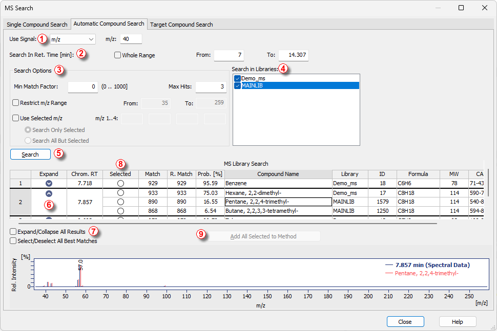

Using Automatic Compound Search
When you run an Automatic Compound Search, the Automatic Compound Search tab of the MS Search dialog opens.
  1. In Use Signal , choose the signal on which peaks will be detected and matched with the spectral libraries. You can select any standard signal (including TIC), an external signal, or a signal extracted from raw data (in which case select the desired m/z in the provided field).
  2. Optionally adjust the search parameters as needed, i.e. Search In Ret. Time , Search Options or Search in Libraries . These options are the same as in Single Compound Search.
  3. Click the Search button. The search will automatically run for all peaks identified in the TIC, BPI, or on the selected m/z in the chromatogram, using the selected libraries. By default, only the best match for each peak is displayed in the table.
  4. To view additional matches for a peak, click the Expand icon in that row. To expand or collapse results for all peaks, use the Expand/Collapse All Results checkbox .
  5. After reviewing the results, select the desired matches in the Selected column using the check box (maximum one search result per peak can be selected).
  6. Click Add All Selected to Method to add the chosen compounds to the MS Method.
